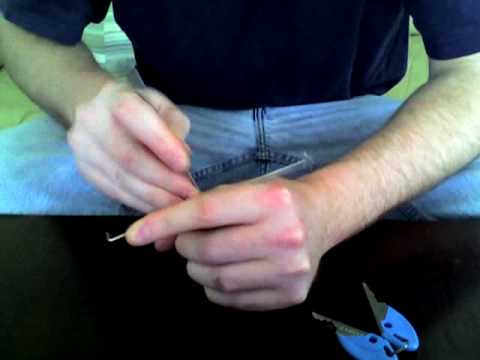

Picking BiLock Next Generation
I remade this video because I've cut the picking time down dramatically, In this video I pick an 8 pin Next Generation BiLock model EX Short in a Kryptonite/Schlage KS22 padlock this lock has 4 pins on 2 sides this lock doesn't use upper pins like a normal lock it uses 2 sidebars 1 on both sides the pins have holes in them and when they are lifted to the correct position the teeth in the sidebar fit into the holes in the pins, when all the pins are at there proper positions the sidebars retract into the plug allowing it to turn, this lock also has a slider mechanism in the middle that stops the right hand sidebar from engaging, it must be depressed to engage the right hand sidebar allowing it to retract into the plug once the pins are properly lifted. surreptitious
