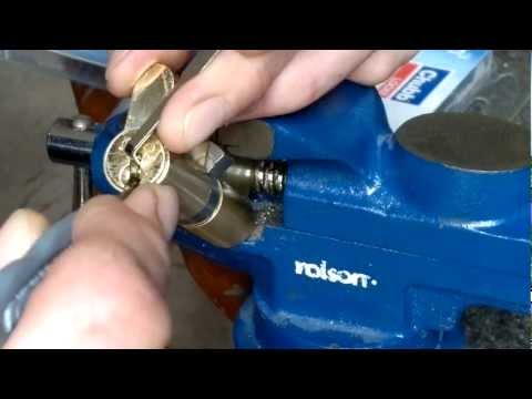

CHUBB MEDECO M3 spp and gutted
6 pin with 'angled-cut' key pins that need to be set rotationally aswell as vertically. First you set the pins by rotating untill all the pins become loose, then it will let you push in the sidebar notch, and then you can raise the pins to the sheer line. This is the quickest ive been able to pick it with loads of practice! bitch of a lock!! :)
