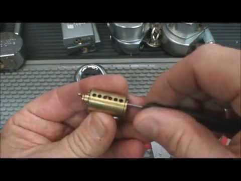

This is the natural follow-on to the video "American Padlock Bypass Tools". American Padlocks are pretty good but the company (now owned by Master Lock) cuts a couple of obvious corners that sabotage the lock's quality: Putting only 5 pins in a 6-pin core, and using a thin (0.010") wafer to protect against bypass attacks. I describe how to "rebuild" your American Padlocks to make them less pickable and immunize them against bypass attacks. Forever.
