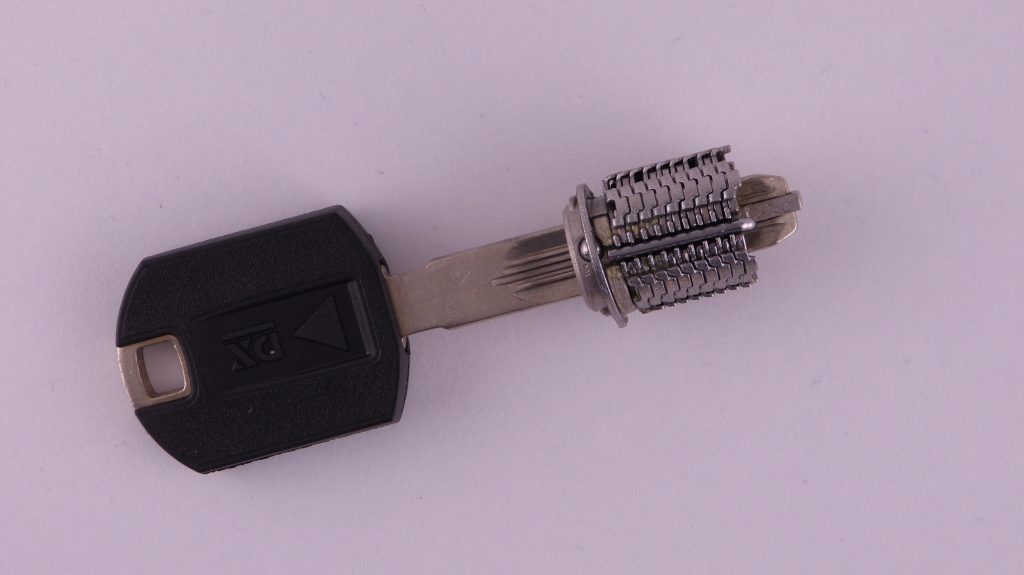

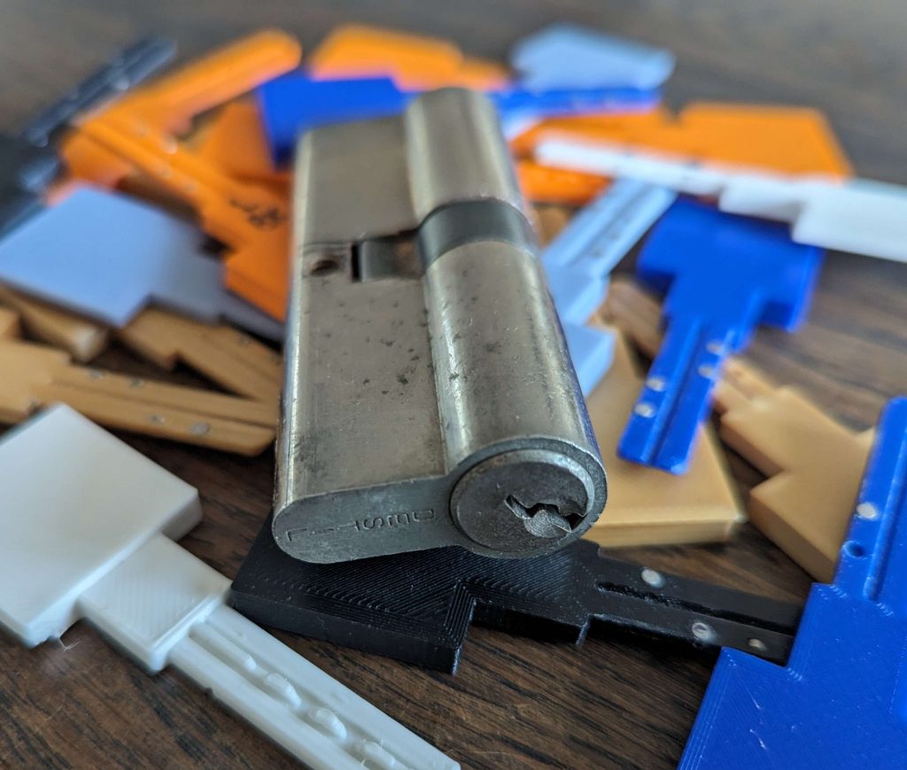

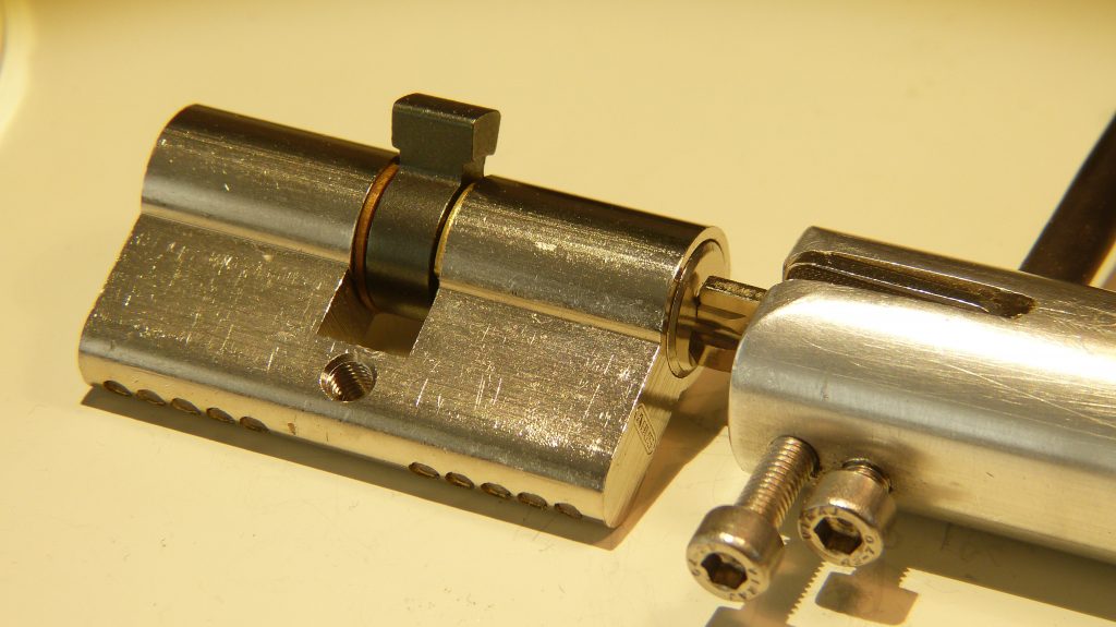

    3D printing keys for Protec2
    This story is based on the work from Reinder Stegen, in which the Protec2 was reverse engineered and scripts for parametric key generation are written. Reinder worked with James Wah for the parametric webblification. As in, a free to use online webgenerator for all your Protec2 key needs. To get the keys to the real […]
    Источник...

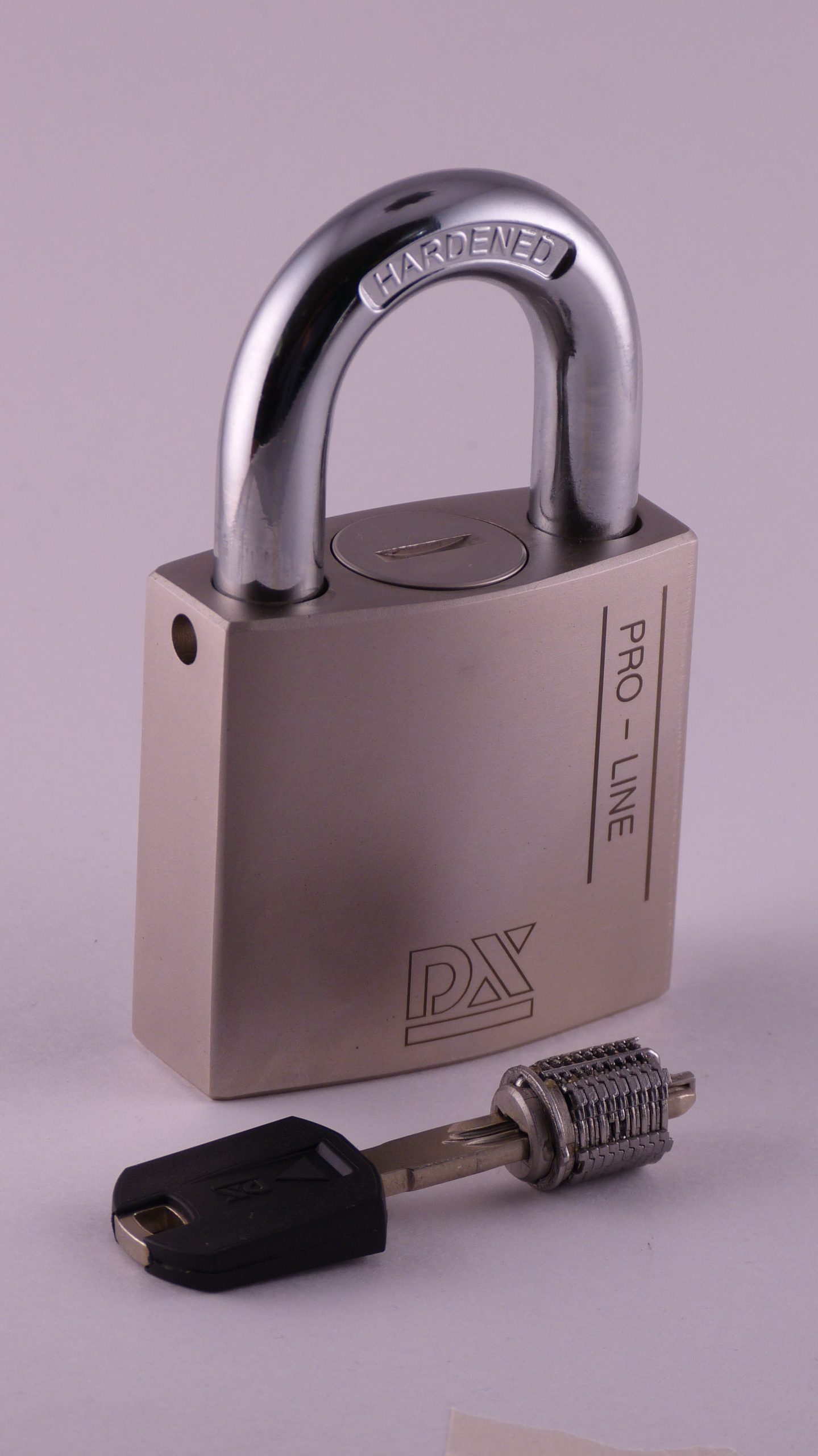

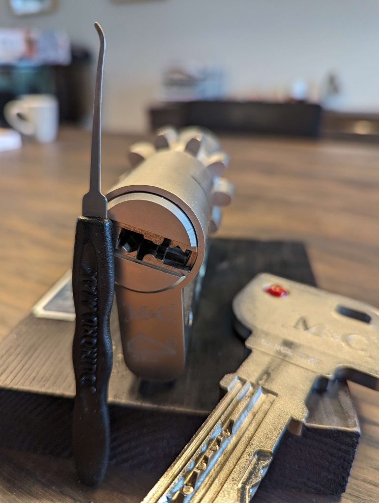

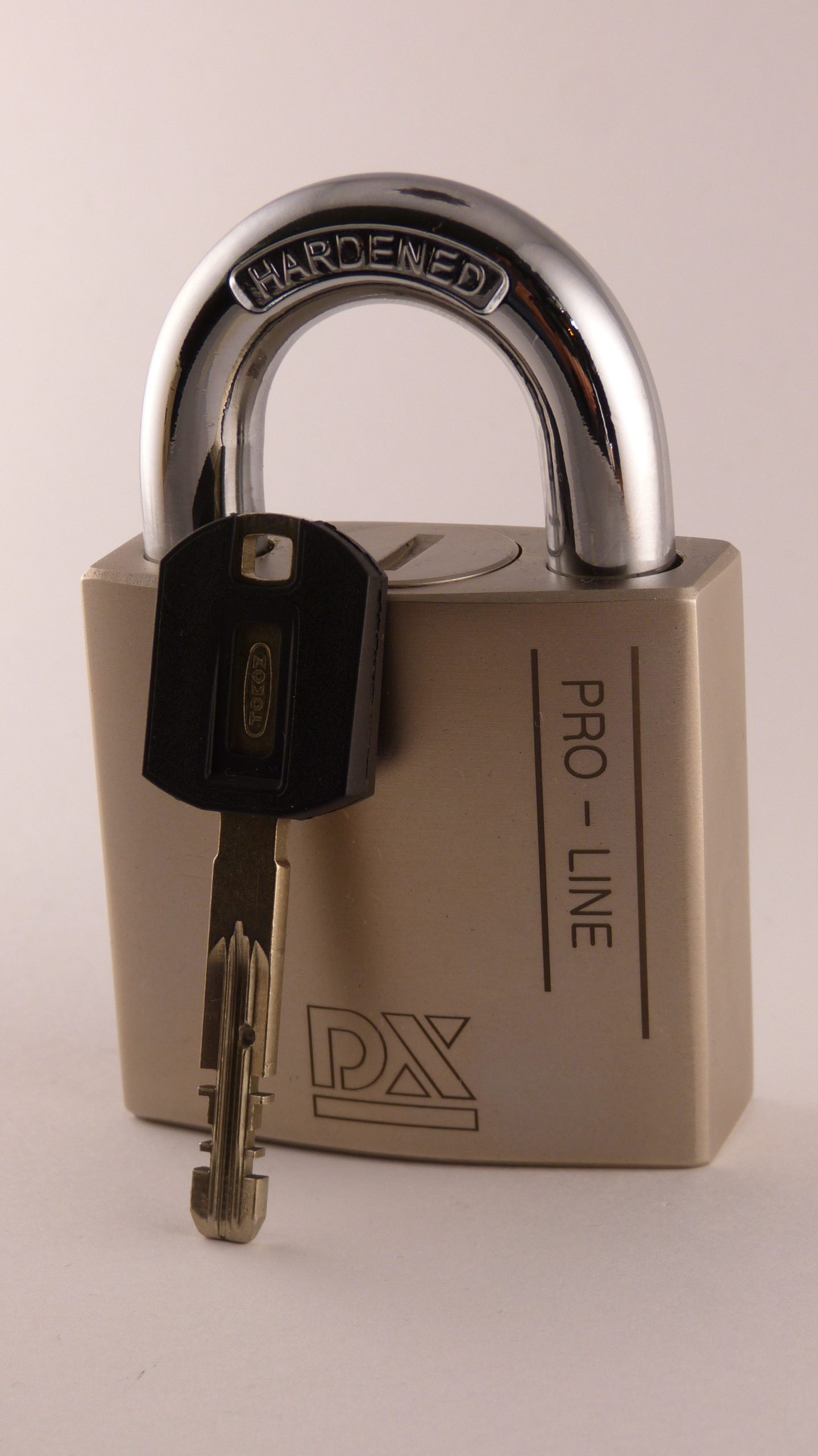

    Dulimex PRO-LINE challenge

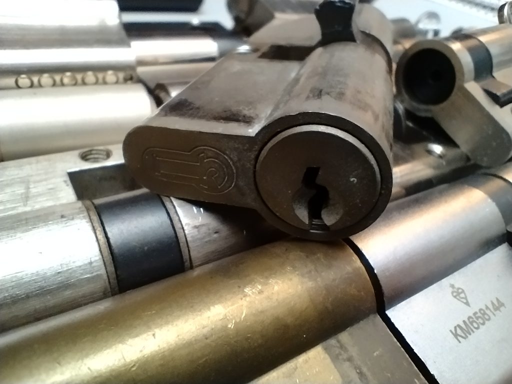

    Dulimex kindly sent us the new PRO-LINE padlocks as a lockpicking challenge. Picking these won’t be easy, as the padlock features a Tokoz Pro core with eight disks and a disk blocking system similar to Abloy Protec. While it’s fun to spend days picking the lock, picking isn’t necessarily a realistic threat for your normal […]
    While it’s fun to spend days picking the lock, picking isn’t necessarily a realistic threat for your normal security needs. This Dulimex padlock achieved a SKG** rating. While it’ll not be indestructible, you have the assurance it’ll be at least a few minutes with a selection of power tools.
    We received five locks from Dulimex for the challenge. The locks will be available at LockCon, and we will borrow them to pickers thereafter. If you are up for it, please send us a message.

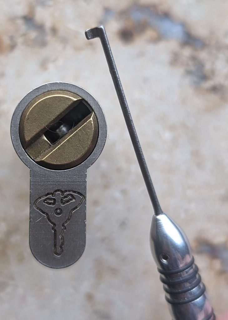

    At first glance, the core looks similar to the Abloy Protec. But there are quite a few notable differences. The Tokoz very cleverly uses the spacers to build up the core. The construction makes it difficult to reassemble the lock, so please keep them together.
    Thanks everyone for giving me tips on picking these locks. The tips can be summarized as, to use dimple picks instead of a 2-in-1, unless one is custom-made for the Tokoz. Furthermore, the key guide can be twisted, which bricks the lock. When the lock is picked, then use a modified key to rotate the key guide, instead of forcing it from the front.
    The best videos for the picking attempts are:
    CCBY4.0 Jan-Willem Markus Toool Blackbag. I’ve added an archive of these pictures on the link below.
    20230930_Dulimex_PRO-lineDownload

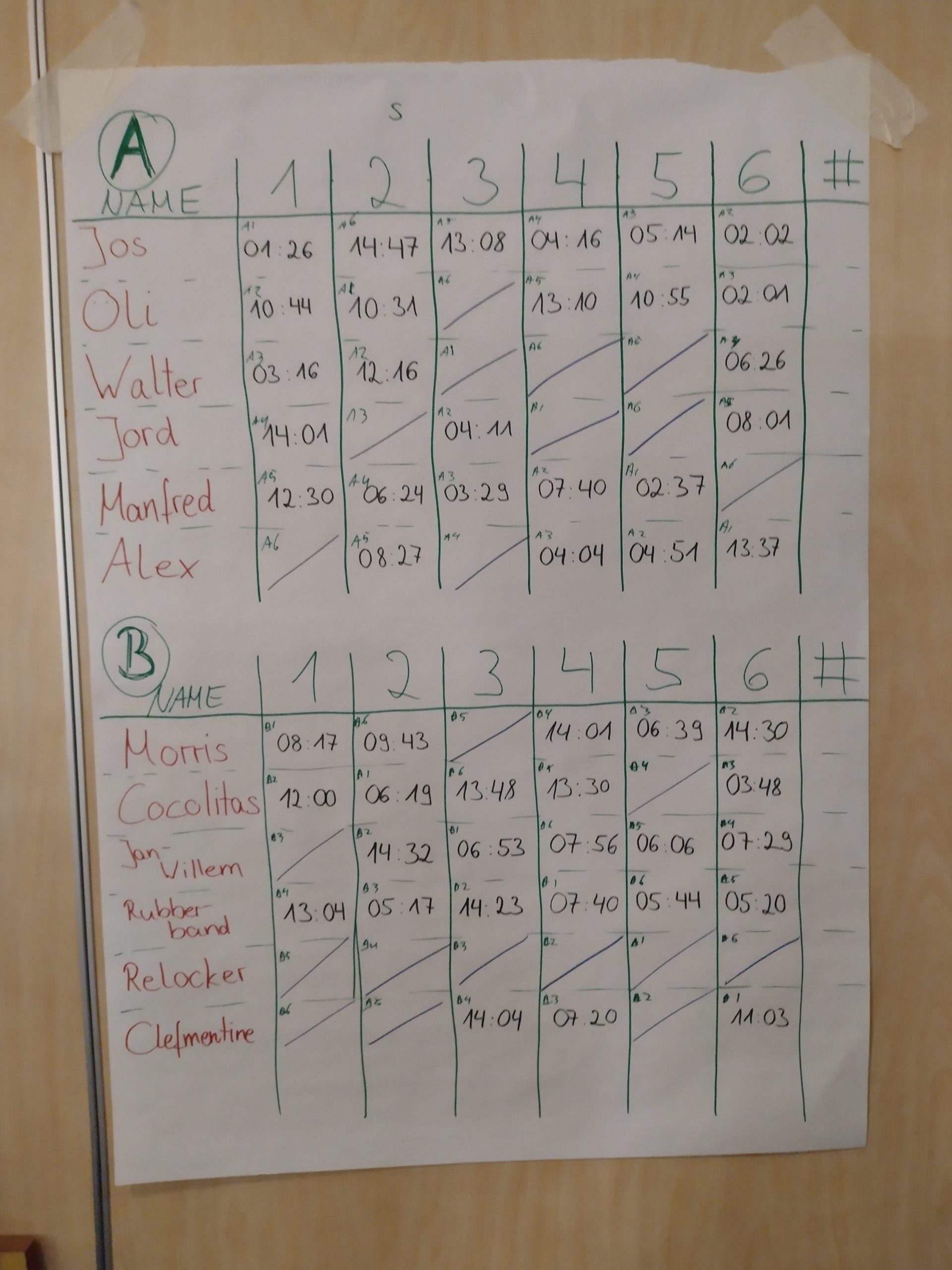

    The Dutch Open 2023 Disc Detainer competition was held in a self-timed format. Throughout LockCon, the participants worked on getting the best times on the five Disc detainer locks: 001 Fort Knox, 002 Parkside, 003 No-name, 004 Abus Plus, 005 Abus Plus with butterfly disks. We used the Sparrows Disc detainer pick with a 3D […]

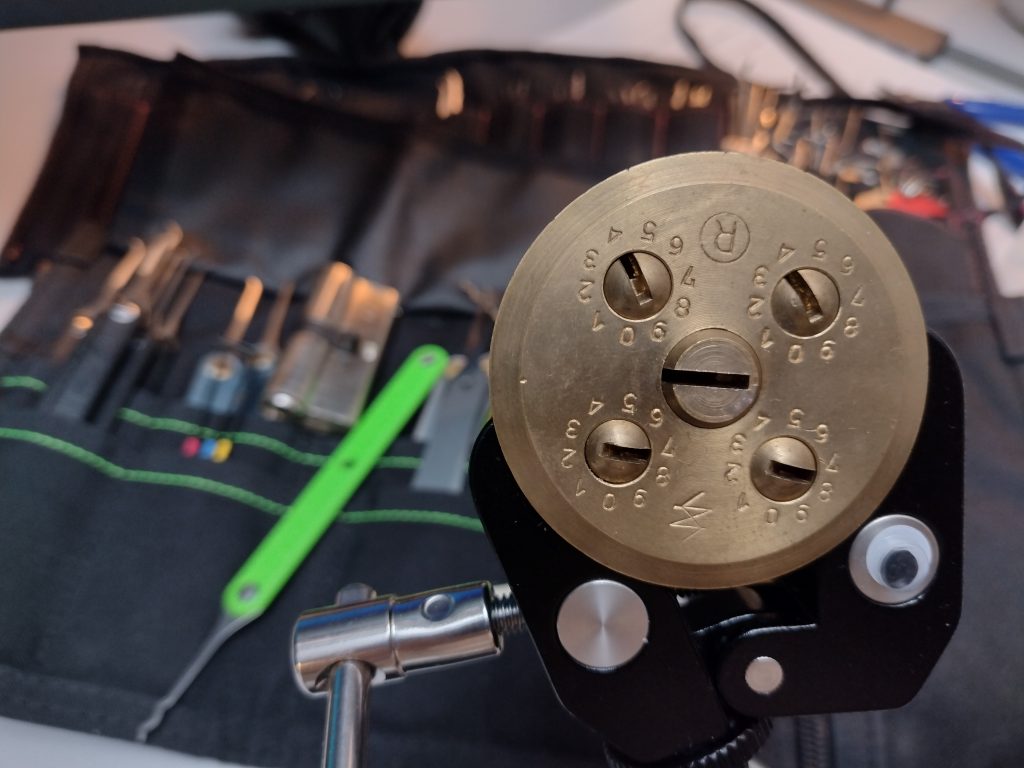

    We used the Sparrows Disc detainer pick with a 3D printed spacer. One of the Sparrows tools was modified to allow tensioning lock 004, the Abus 37/55.
    Nitiflor won the competition by opening all the locks and won a Sparrows Vorax set. ImSchatten360 opened all locks as well, but spend more time in total and won the second price, a Sparrows Tuxedo royale. Matt Smith opened four out of five and won for the third price, a Sparrows Tuxedo set.

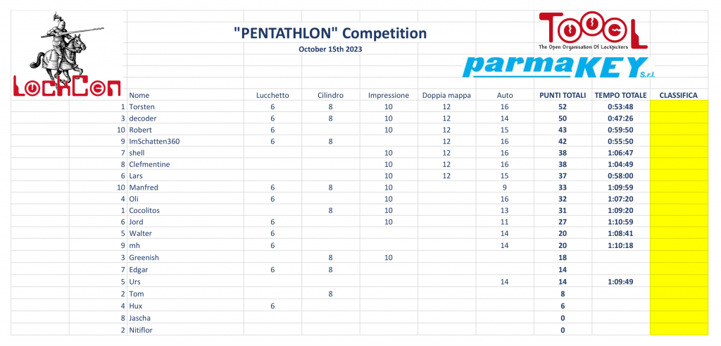

    The Pentathlon competition is a series of five lock challenges sponsored and hosted by Parmakey. The competitors had to pick a pin tumbler, pick a dimple, impression a key, pick a safe lock, and pick a car lock. Twenty competitors joined the challenge. Torsten won the competition with 52 points and won a Sparrows Vorax […]
    Torsten won the competition with 52 points and won a Sparrows Vorax lockpickset, a book on historic keys. Decoder, with 50 points, won the second price and received a Sparrows Tuxedo Royale and a book on safe lock history. Robert won the third price with 42 points and received a Sparrows Tuxedo set, as well as a book on locksmithing history. All three also received a bottle of Nabucco wine.

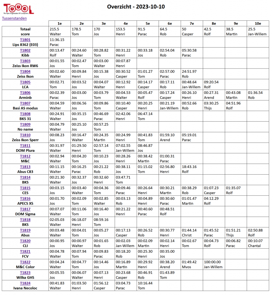

    Toool NL Competition, 2023
    The Toool NL competition is a lockpicking competition which is available at meetups for the members. About twenty locks are selected, and the members improve the picking times throughout the year. Opening a lock in the best time gives ten points, 2nd best time nine points etc. The member with the most points at the […]
    Opening a lock in the best time gives ten points, 2nd best time nine points etc. The member with the most points at the end of the year wins the competition. https://toool.nl/competitie2023/
    Jos, Henri, Jan-Willem and Rob made a quick start in the competition at the first meetup. At the Eindhoven meetup, Walter took the lead, and kept the top score throughout the year. There was more competition for the second and third place, and was held and lost by many. (Week by week: https://toool.nl/competitie2023/tussenstanden.html)
    Walter won the competition with 215.5 points (out of 240) and received a Multipick Kronos Electropick. Tom won the second with 178.5 points and received the Multipick Elite Meister 19-parts lockpick set. Jos won the third price with 170 points and received a Sparrows Vorax pickset and a Sparrows pinning mat.
    Kudos to the dozen people who have opened at least one lock in the competition!

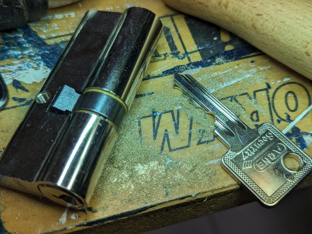

    Dutch Open 2023 Impressioning results

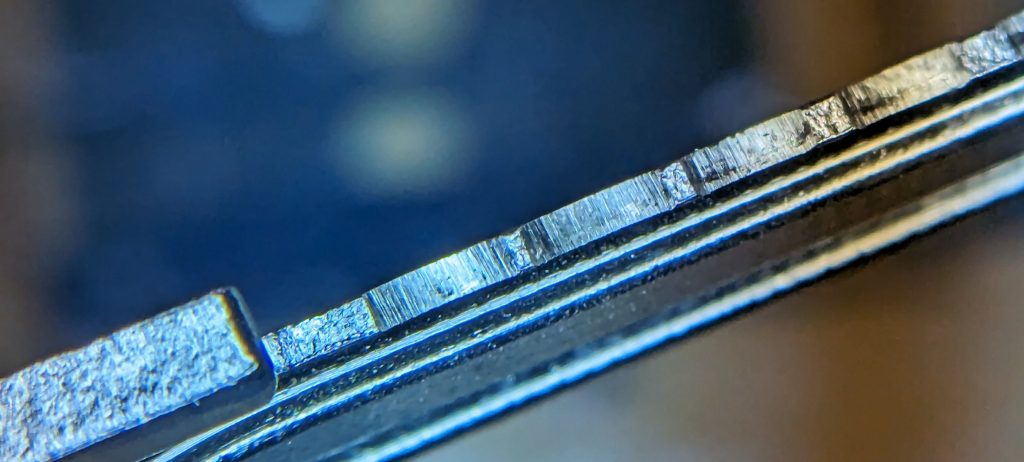

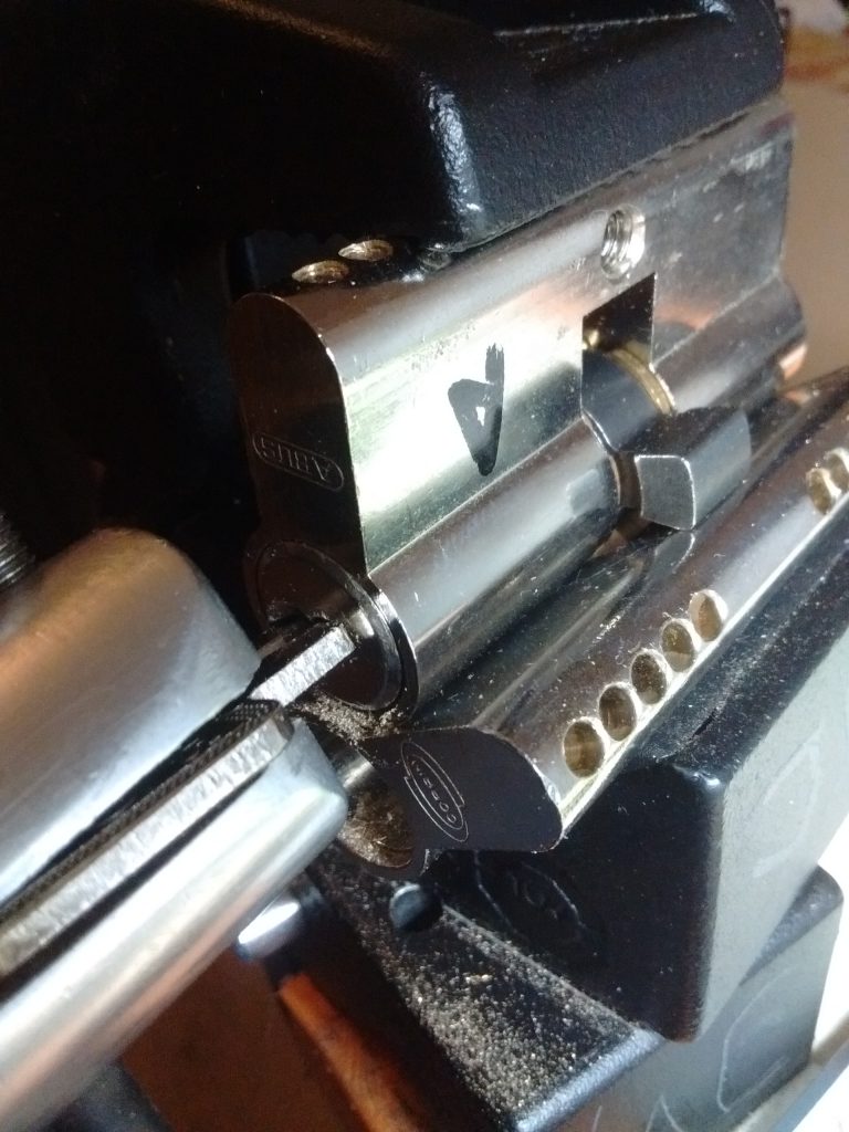

    The Dutch Open impressioning championship is a competition in making a key for a C83 cylinder in the least amount of time. For the qualifying round, 34 competitors joined, of which, 27 (~80%) opened the qualifier lock within 60 minutes. The quickest twelve continued to the A and B finals, where they attempted six more […]
    The Dutch Open impressioning championship is a competition in making a key for a C83 cylinder in the least amount of time. For the qualifying round, 34 competitors joined, of which, 27 (~80%) opened the qualifier lock within 60 minutes. The quickest twelve continued to the A and B finals, where they attempted six more locks in 15-minutes per round.
    Jos won the competition and received the new Multipick ERAS dimple and disc detainer set. Manfred won the second price and received a Sparrows Tuxedo royale lockpickset and a Multipick cutaway lock. Oli received the Sparrows Vorax lockpickset as well as a Sparrows pinning mat as a third price. Alex, Walter, and Jord received the Multipick Elite LockNoob 10-piece duo peak set, Sparrows Tuxedo Royale, and Sparrows Tuxedo, respectively.
    RubberBanned won the B-finals and received a Sparrows Vorax lockpick set. Jan-Willem with the second place won a Sparrows Tuxedo royale. Cocolitos with the third place won a Sparrows Darkshift lockpick set. Morris, Clefmentine, and Relocker received the Sparrows Darkshift, and Sparrows Tuxedo set.

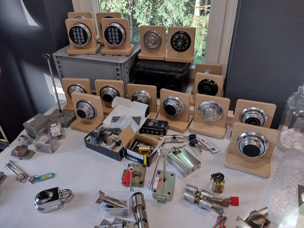

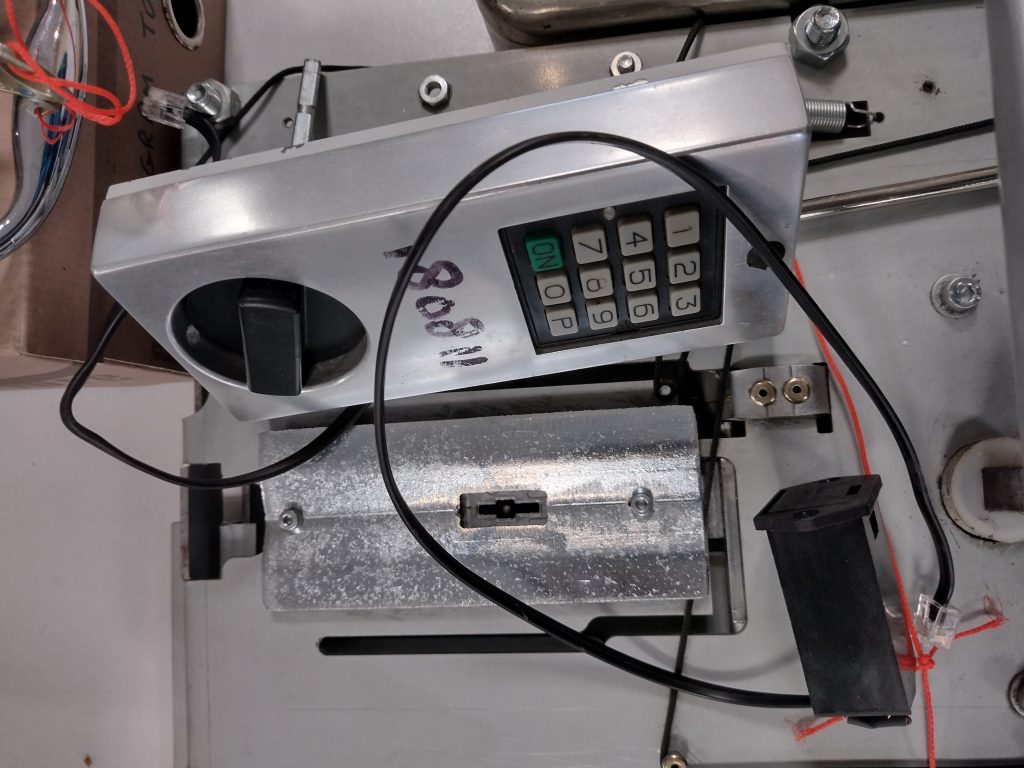

    Saturday we started with my talk about electronic safe locks. I’ve shared my insights in how you can attack embedded systems and specifically electronic safes. The target is the Kaba-Mas X0 series locks. Starting from the X07 from ’92 and building to analyzing the electronics of the X09. I’ve shared about hardware reverse engineering, but also high-end techniques like laser fault injection used to extract the memory content of the lock. While still a lot of work has to be done, progress is made.
    Electronoc_Safe_locks_LC23_v4-1Download

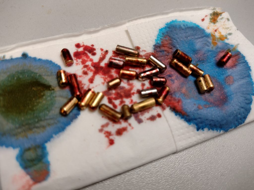

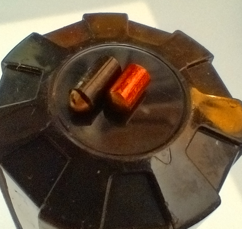

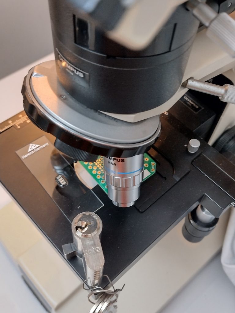

    Asking the community: How are pins painted?

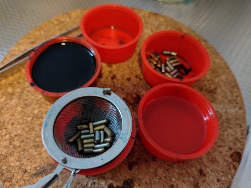

    A while ago, we had a discussion on our Discord server on how the pins for pinning kits are painted, as achieving the same effect at home was quite appealing. For example, to accentuating the different pins for teaching, or to make cutaways more fancy. In this short blog, I’ll share what has been tried, […]
    In this short blog, I’ll share what has been tried, and how we can use your help to solve the mystery.

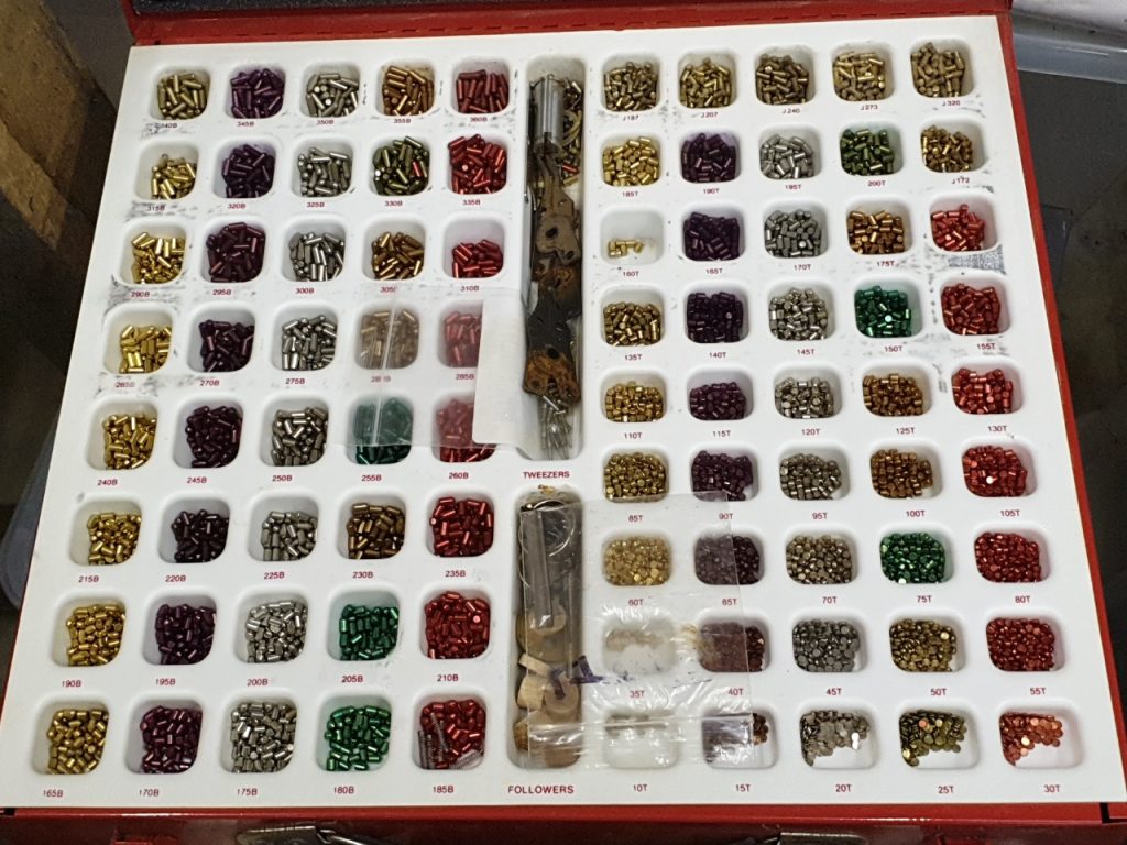

    A picture of a pinning kit by Nigel, Toool UK.The first clue was from a pinning kit manufacturer, as they shared with a community member that the pins were soaked in bowls of food coloring. I’ve bought water based, and later alcohol based food coloring and tried the same. The color doesn’t really stick to the surface of the metal surface, as the metal was not clean enough. I wasn’t too scientific about improving the wetting and tried different cleaners. The paint didn’t stick to the pins, came on thick, or rubbed off with a towel.
    A better attempt was to use alcohol (based) paints used for arts and crafts, as the pins are indeed painted. But the effect was fairly uneven and the paint washed off easily.
    The best attempt was also the simplest, by painting the pins with permanent markers. The process isn’t complicated, simply rub the permanent marker on the pins. For a one-off cutaway, this process is quite feasible, but not for big quantities. Cleaning the pins beforehand will likely improve the results as well.
    Edding 390 permanent marker for scale.We have tried a few ideas, but this is where we are currently stuck. If you have an idea on how to paint these pins more evenly, leave the suggestions below. It would even be better if you gave the suggestions a go and shared the results with us.

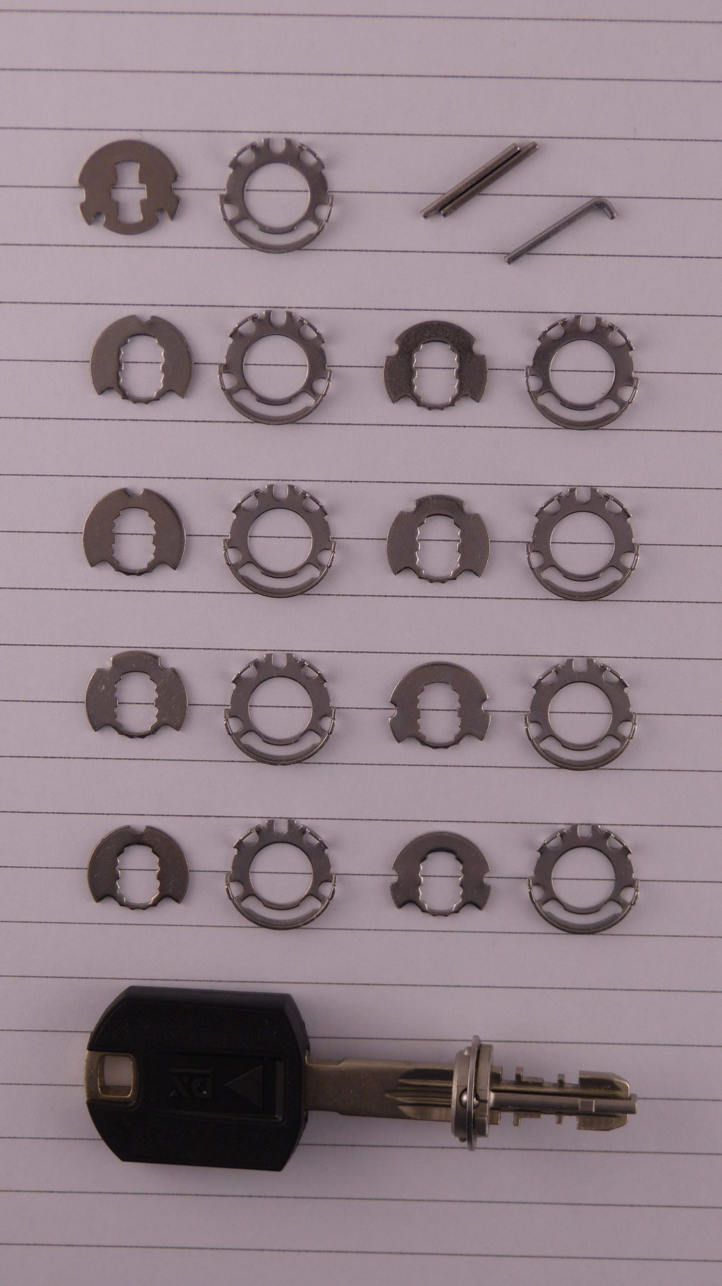

    In learning lockpicking try to get all advantage you can get. A good first step is to learn as much as possible about the lock. For example, You should disassemble and reassemble the lock a few times, but looking at pictures on the lpubelts or lockwiki are good options as well. The next step is […]
    In learning lockpicking try to get all advantage you can get. A good first step is to learn as much as possible about the lock. For example, You should disassemble and reassemble the lock a few times, but looking at pictures on the lpubelts or lockwiki are good options as well. The next step is to assemble the lock with fewer locking elements, pick it, and increase the difficulty after each success. This is a well understood practicing method for pin tumbler locks, call progressive pinning.

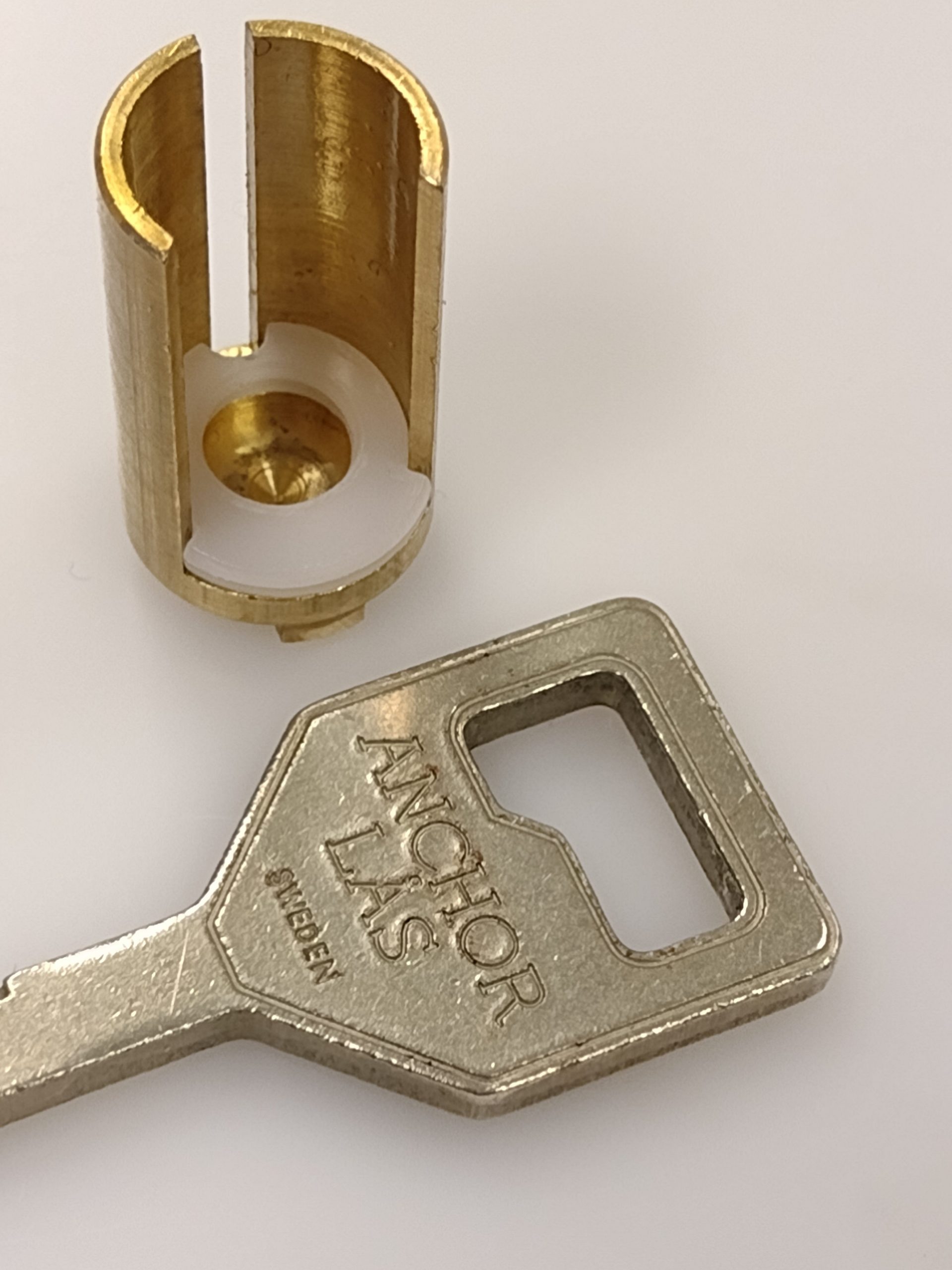

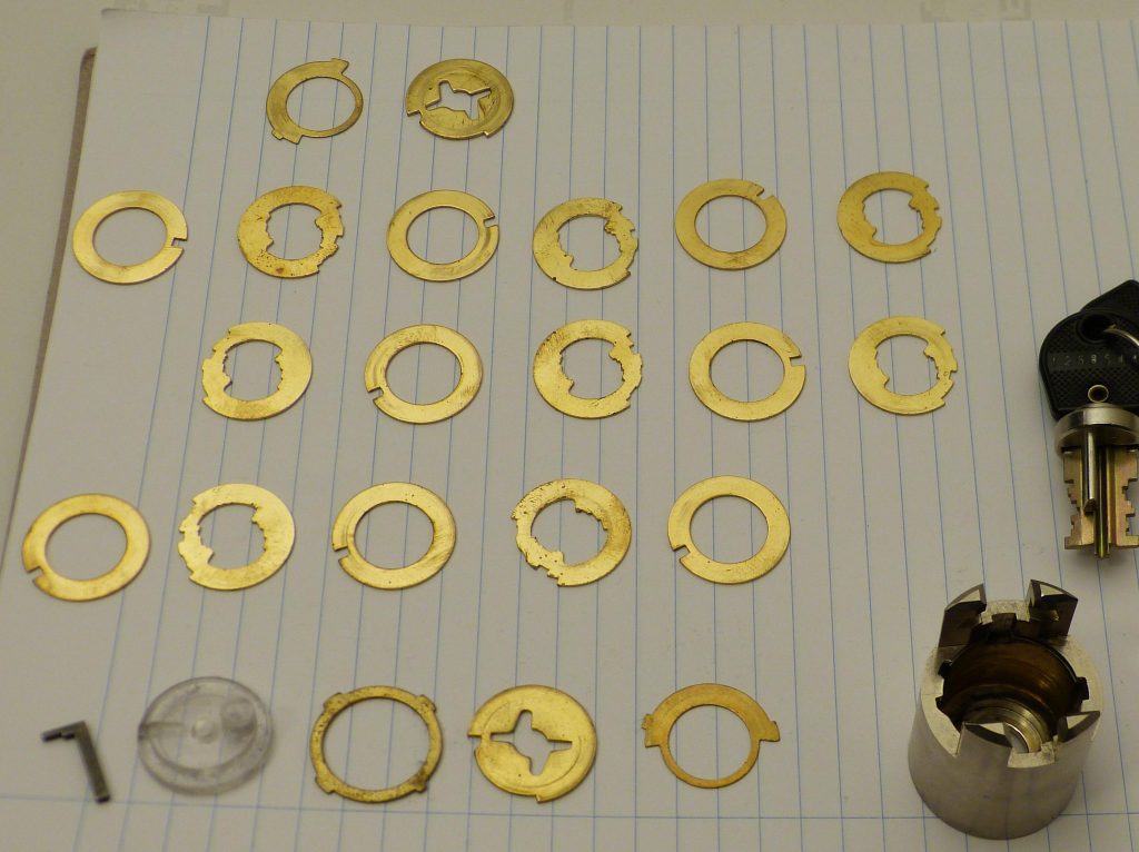

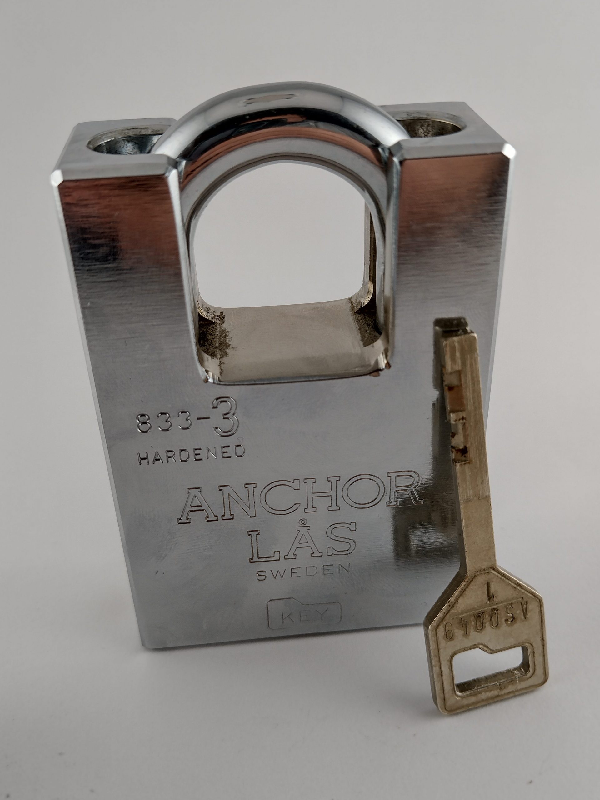

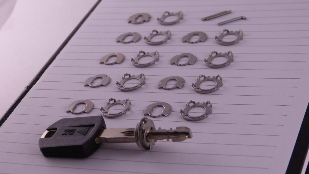

    I’ve built several progressive locks for myself and for teaching lockpicking to others. Of some locks, I’ve got a keyed alike set. In this way, you can practice the locks without the (sometimes tedious) opening and reassembly of the locks. For the practice session, just work through the locks in the set.
    For disc detainer locks we aren’t lucky as the locks don’t function well without all the elements. The locks consist of a stack of code discs and spacers and all live in a partially cut hollow tube. If you have several of the same lock, you can use the spacers from one lock to fill the progressive lock. This technique worked well for an attempt to pick the Rosengrens 32A81 lock.
    Disassembled Rosengrens 32A81 Safe deposit box lock.Dmac shows an clever alternative for regular disc detainers in this video. https://www.youtube.com/watch?v=ehHG-BhgdMs He is replacing part of the disc stack with a properly sized tube to take up the space of the missing discs. The tube allows the key to operate the lock and has enough movement to move freely and not impede the sidebar, but small enough so the sidebar doesn’t drop in the core. This is a clever trick which is certainly worth testing.
    In this post, I propose an alternative solution which is more generic, and will most likely work for all disc detainer, lever, and wafer locks. I’ve designed a spacer to fill the lock. The spacer shape can often be reproduced from the original lock parts in most CAD packages within hours. As a proof of concept, I’ve designed the spacers for the Anchor Las and laser cut the parts at Hackerspace Bitlair in Amstersfoort.

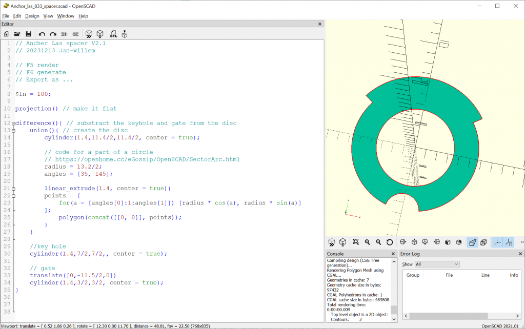

    My process is quite straight forward: Measure the part, design it in OpenCAD, determine the laser parameters, cut the part, test the part. Then adjust and repeat the steps until satisfied with the results. (Or when you run out of material/time/money, whatever comes first.) It is like CI/CD, but in hardware, with an iteration cycle of about five minutes.
    In the table below, I’ve captured the measurements of the core from the Anchor Las 833-3 padlock.
    ItemSizeDisc pack20.51 mmDisc1.395 mmSpacer0.5 mm (calculated)Core13.92 mmSidebar1.97 mmKey width5.1mmSpacers stack0.5 mm + 0.28 mmAnchor Las measurements with a micrometer. Getting the dimensions into OpenSCAD isn’t too difficult. I did however reuse someone else’s code for a partial circle, which isn’t trivial in this scripting language. (The code will be on the bottom of the page)
    Laser cutters are amazing machines, and I’m always excited when finding a new use for the tool. My go-to materials are acrylic, Delrin, and the occasional sheets of triplex. While, acrylic isn’t the most robust, it makes for great visualizations. POM (Delrin and Acetal are the brandnames) is an engineering plastic great for key gauges and other locksport tools. It also so happens to work great for lock replacement parts.
    To get the part the correct size, we need to compensate for the kerf (laser cut width). While it can be measured, I chose to do trial and error: change the kerf compensation in the Lightburn laser software and measure the parts with a micrometer. After I was satisfied, I ran a small batch of a hundred rings, just so there are enough to play with for me and other community members.
    At the hackerspace, we actively share lessons learned. For this one, I’ve found putting a sacrificial material below the Delrin greatly improved the cut quality. Half the power and speed, with two passes also worked well. The laser parameters are saved to the Bitlair wiki for others to use in the future.
    Back home, I’ve assembled the lock with the spacers and found them to be slightly too large. The sandpaper took off the difference quite easily. After reassembly, the lock works great with the key and it’s hard to distinguish from a lock with a complete disc pack. (I see options for a trick lock).
    I’m looking forward to picking it, and will have others play with the lock as well to gather feedback on how the parts affects picking. As I expect the Delrin spacer have noticeably more friction than metal on metal, it will likely be beneficial to keep code discs in between original spacers. Furthermore, the lock works fine without a shackle and won’t brick on you without one.
    Above are the minimum parts required for a functional front tensioning training lock. I’ve picked the lock a few times with six random code discs. This is nine spacers of 1mm thick, and six of each code disc and metal spacer. After which, I quickly progressed through the other configuration, and picked the unmodified lock an hour later. As the spacers are thinner than discs, I’ve used the remaining metal spacers to fill out the remaining space.
    At the moment we do not have a repository of lock parts, but we will likely create one soon.
    In the meantime, the script for OpenSCAD is attached below. When you create your own discs, please share them around.
    // Ancher Las spacer V2.1// 20231213 Jan-Willem CCBY4.0// OpenSCAD 2021// F5 render// F6 generate// Export as ...$fn = 100;projection() // make it flatdifference(){ // substract the keyhole and gate from the disc union(){ // create the disc cylinder(1.4,11.4/2,11.4/2, center = true); // code for a part of a circle // https://openhome.cc/eGossip/OpenSCAD/SectorArc.html radius = 13.2/2; angles = [35, 145]; linear_extrude(1.4, center = true){ points = [ for(a = [angles[0]:1:angles[1]]) [radius * cos(a), radius * sin(a)] ]; polygon(concat([[0, 0]], points)); } } //key hole cylinder(1.4,7/2,7/2,, center = true); // gate translate([0,-11.5/2,0]) cylinder(1.4,3/2,3/2, center = true);}Anchor_las_833Download
    Copyright CCBY4.0 Jan-Willem Markus, Toool NL

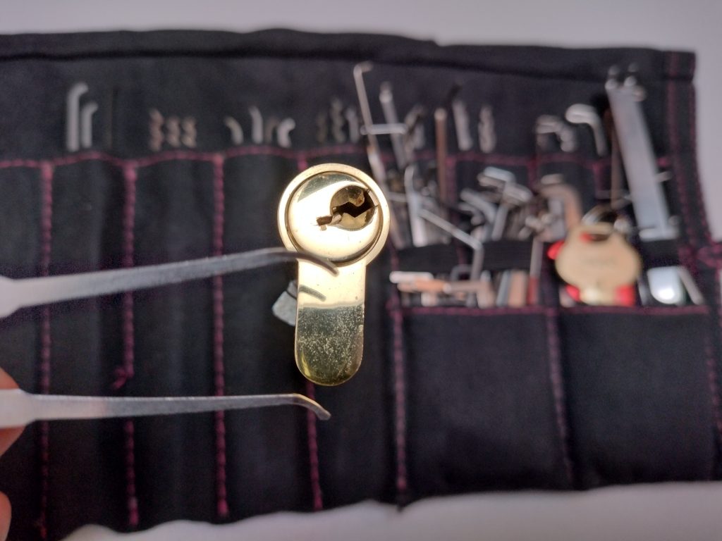

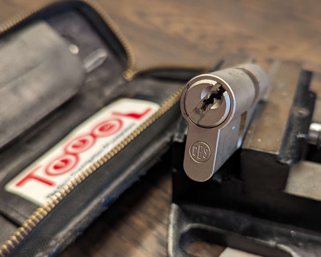

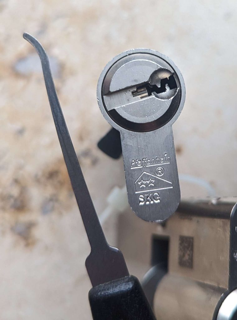

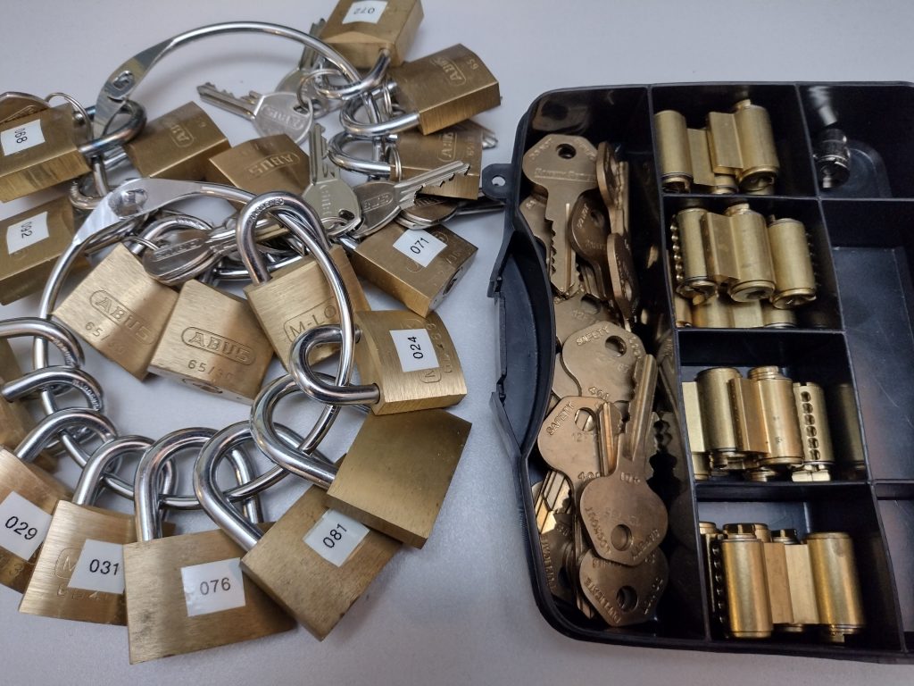

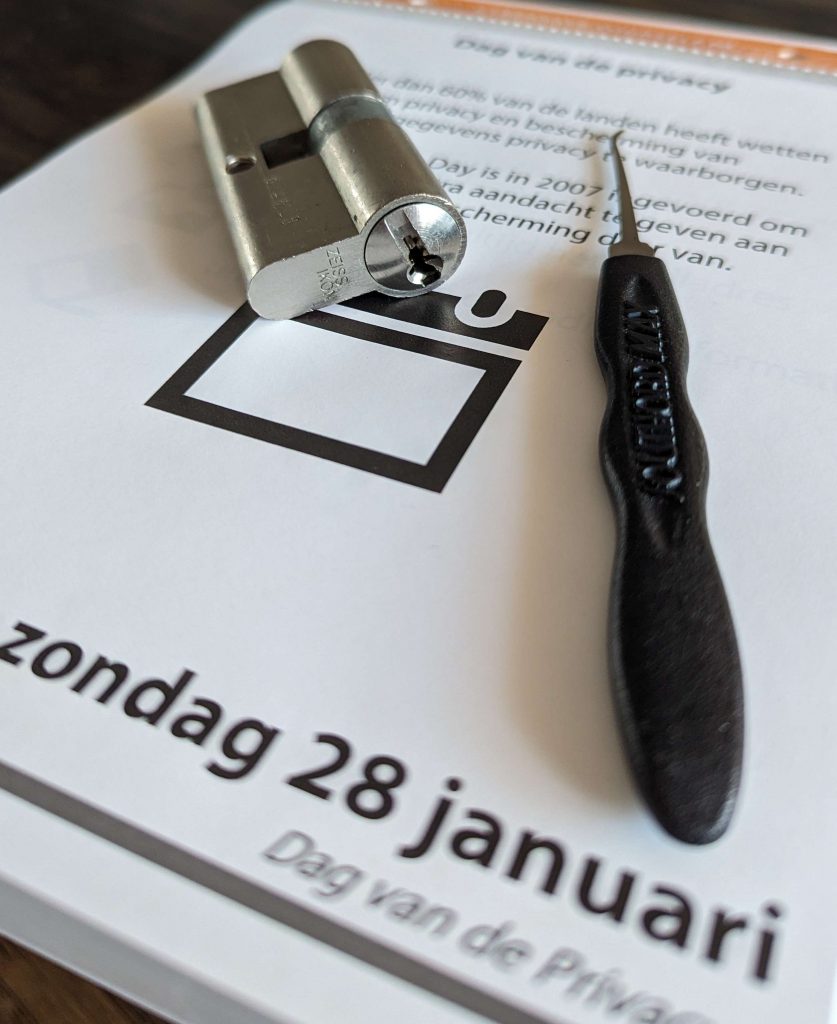

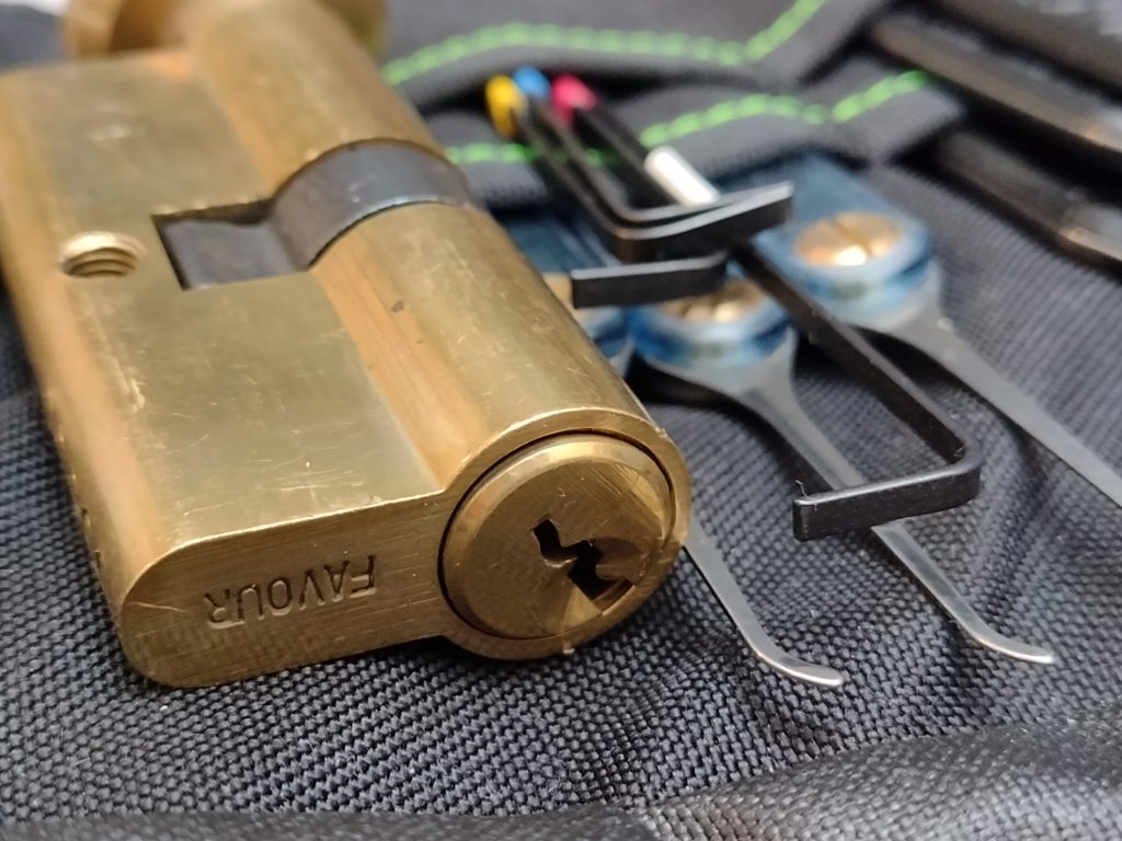

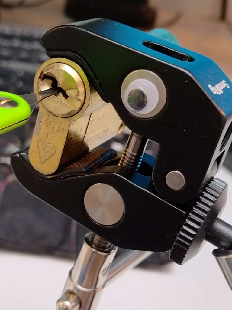

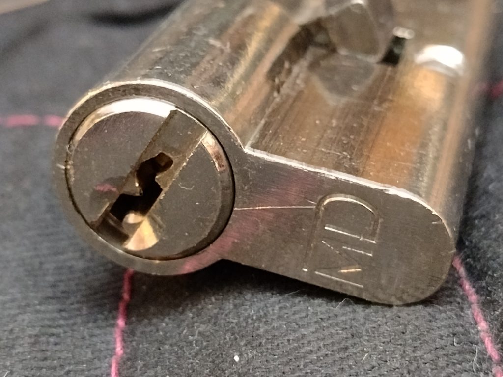

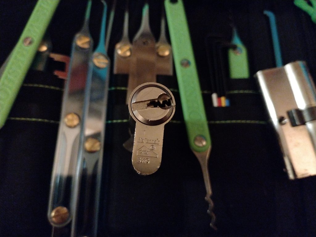

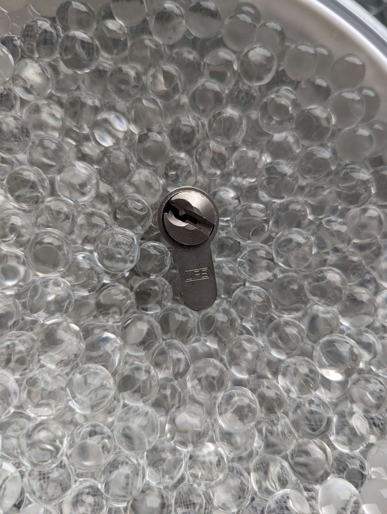

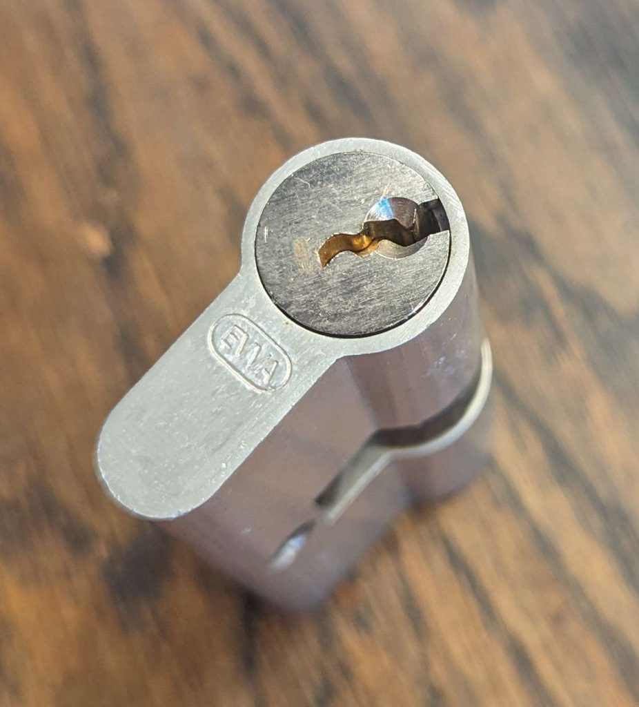

    UKLS January challenge
    The January challenge is a lockpicking game ran on the UKlocksport forum. In short, the challenge is to picks/impressions/opens one lock a day for the days of January. The rules say to post pictures daily and not to play catch up. As in, to pick a lock every day, not just 31 in the month […]
    The January challenge is a lockpicking game ran on the UKlocksport forum. In short, the challenge is to picks/impressions/opens one lock a day for the days of January. The rules say to post pictures daily and not to play catch up. As in, to pick a lock every day, not just 31 in the month of January.

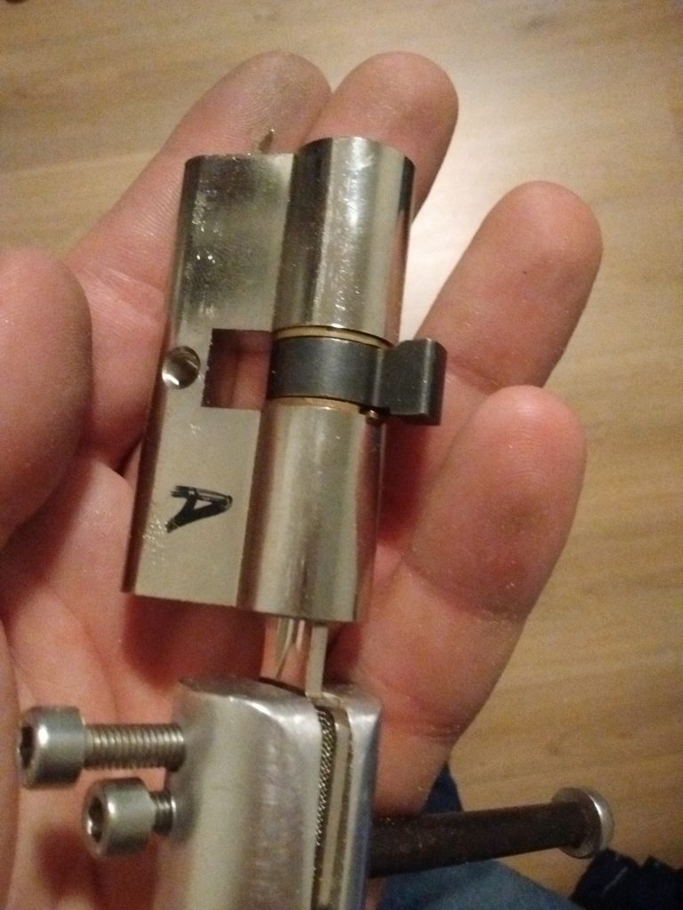

    You can extend your lockpicking streak, if you so wish. Some people extend the streak by a few days, others do a full year. One exemplary lockpicker, Toni, picked a lock a day for 1093 days straight, which is three days short of three years! Furthermore, Toni started a new streak of several hundred lock in 2022, as well.

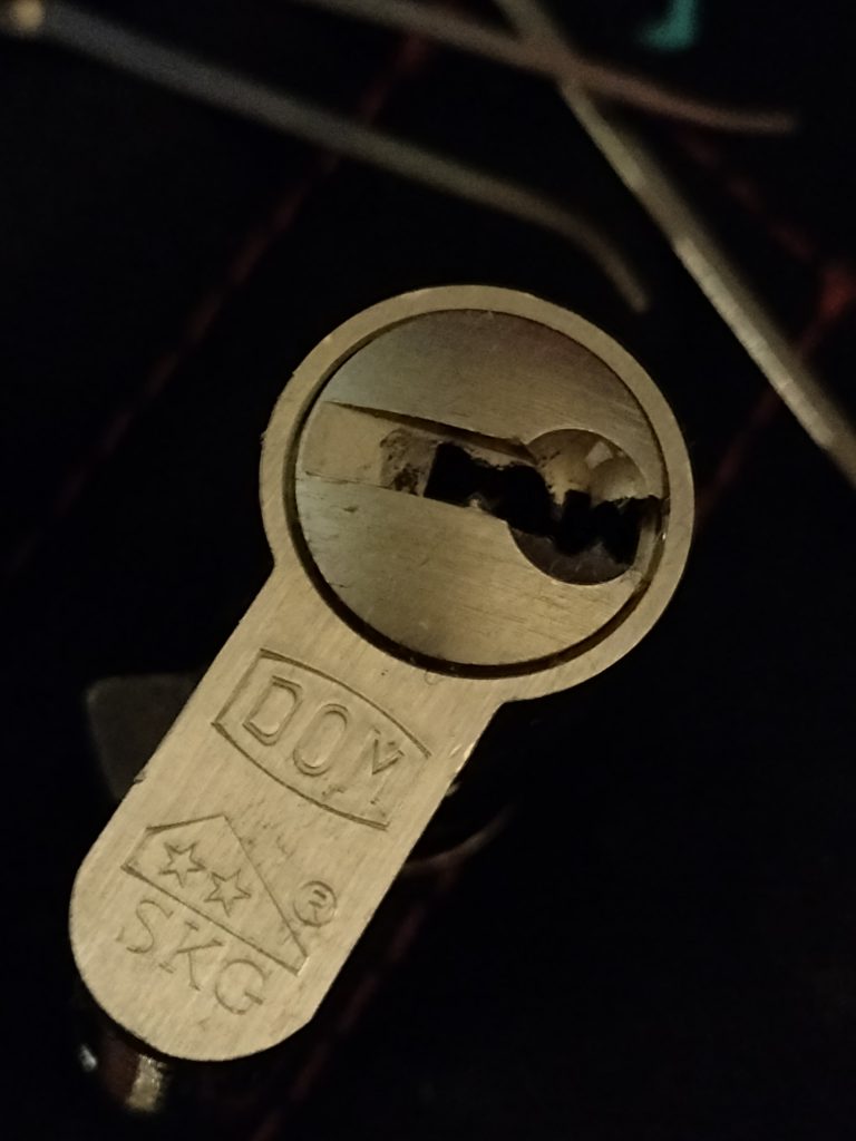

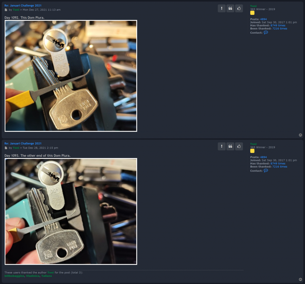

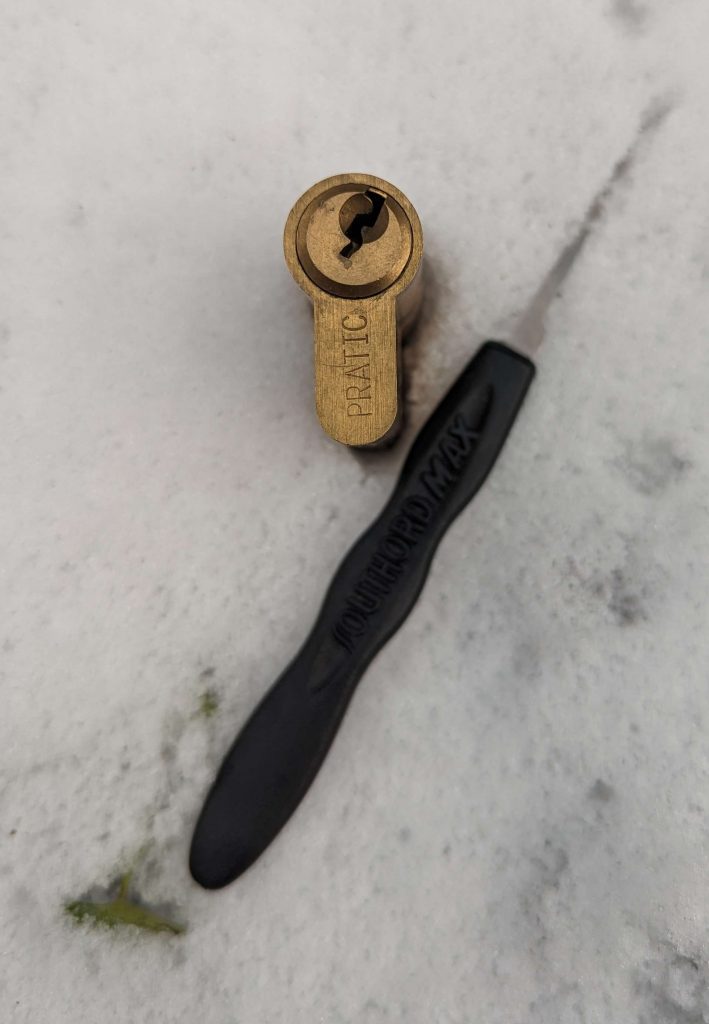

    The last two locks of the lockpicking streak by Toni are both sides of the same DOM Plura.Lockpicking collage of the special picks from Toni from the first 365 locks.

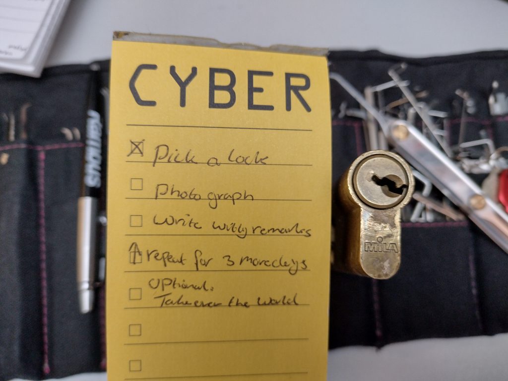

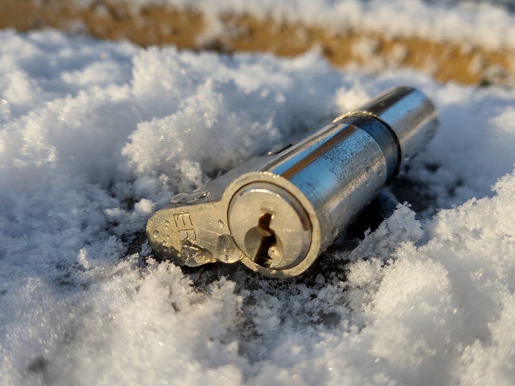

    I’ve used the January challenge as a good excuse to learn a new skill. For example, in 2018 I’ve impressioned a lock a day in January. In 2019, I’ve impressioned a dozen, and picked locks for the remaining days.

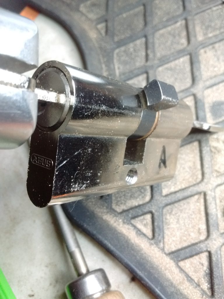

    All of my January challenge impressioning opens are on (regularly repinned) Abus C83. As you can imagine, the pictures of the opens are quite similar, thus I’m only posting a few here.It’s very easy to start the challenge, and then let it drop when that one lock doesn’t open. So to help you along, here are a few tips and tricks.

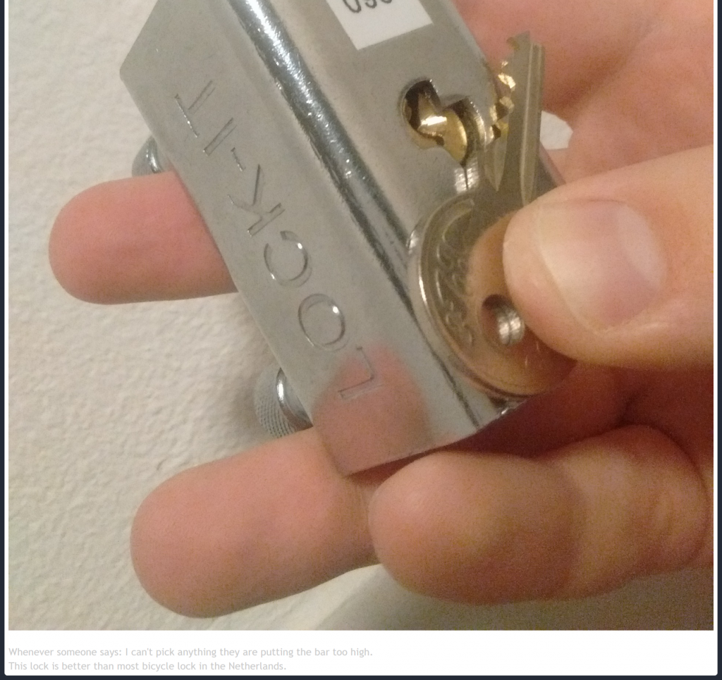

    • Don’t set the bar too high, as the difficulty isn’t as important for your daily lock.
    • Try to incorporate lockpicking in your daily schedule, for example to pick your lock while waiting for public transit, or during a coffee break.
    • Plan out your month so you have enough easier locks for the busy days of the month.
    • If you challenge yourself with an F3D, have a contingency when it doesn’t open that quick, as someone on YT.
    • Skipping posting is better than skipping a pick.
    • Lastly, share your picked locks, no matter if it’s a steak or not. Celebrate the victories will help you stay motivated.
    The two rings are easier locks than the box on the right, but at 25g each, you can’t beat the cores of Master Loto for weight. Toni took a box of these to keep his streak alive during holidays abroad. (Do check the country’s stance on lockpicking, though.)
    With picking a lock a day, you built the lockpicking muscle memory. We as Toool advocate for using the three O of out name, oefenen, oefenen, and oefenen. Which is the Dutch word for practice. In English, you could say to pick locks over, over, and over again.
    If you are inspired, please join the UKLS forum, and start sharing your picked locks. I would like to extend the invitation to any lockpicking streak, also if your streak starts on another date. Next to practice, share your achievements with the community.
    This Kibb is my 1st pick of the year.
    Pictures from Toni have his copyright. The rest are CCBY4.0, as per usual Toool Blackbag license.
    Источник...

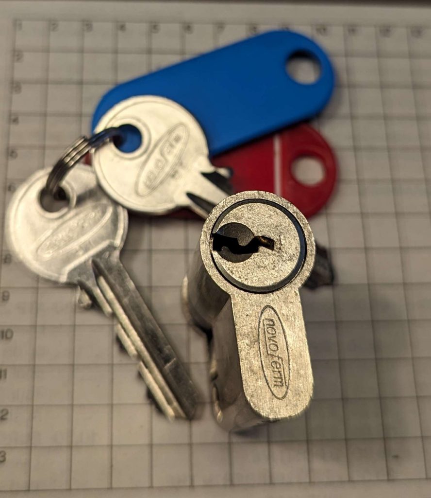

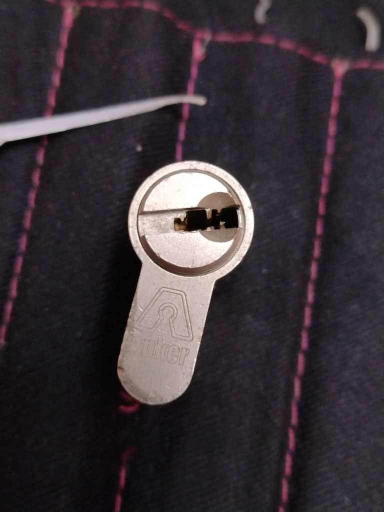

    Challenge completed!

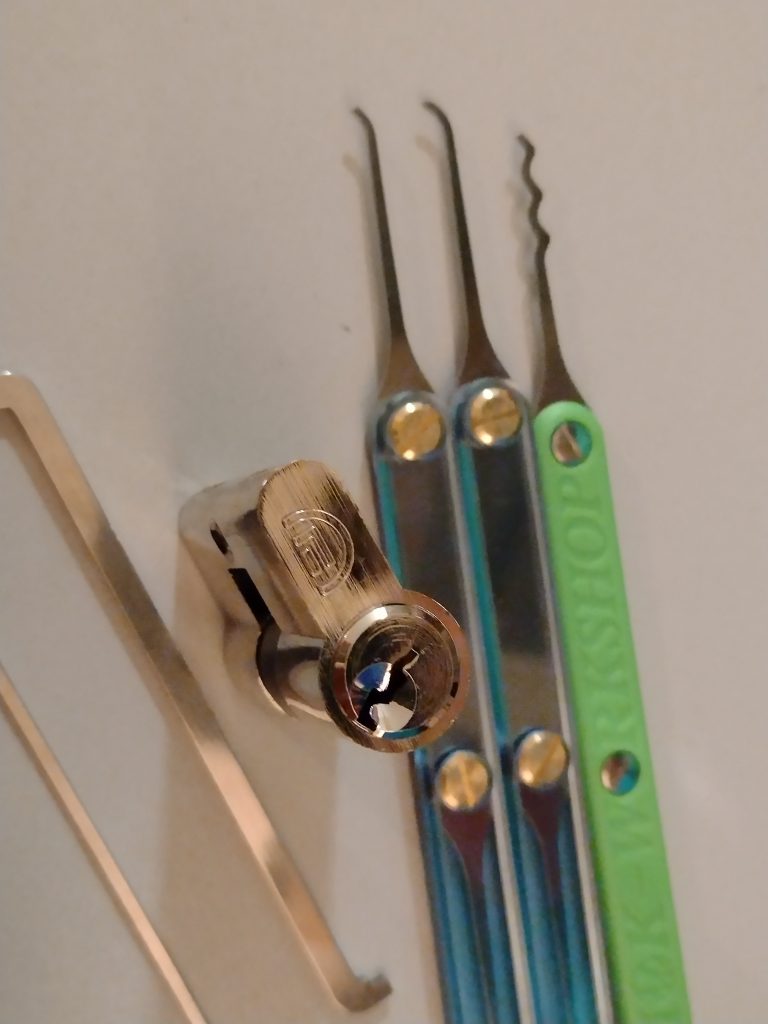

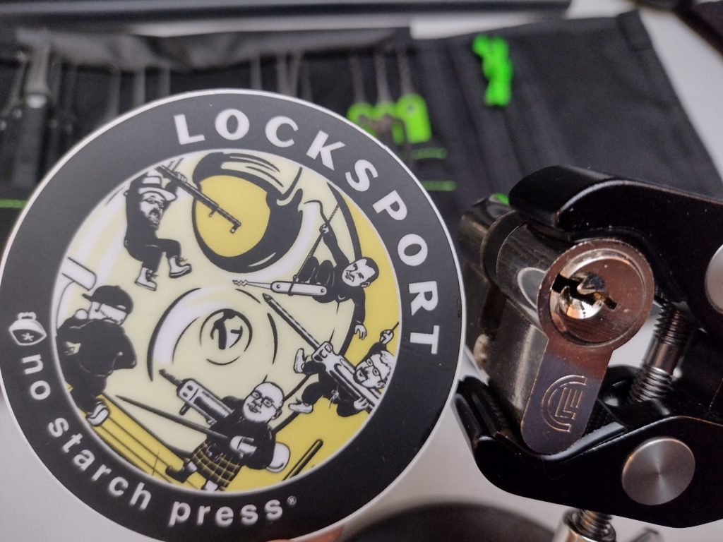

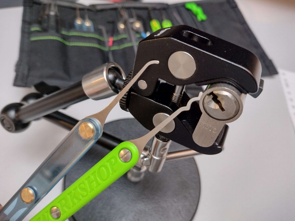

    Walter and Jan-Willem successfully completed the UKLS January challenge, and like to share the lessons learned as well as show off the 31 locks. The challenge is to open a lock, every day, for the days of January. This is a good way to get in the consistent lockpicking practice, and challenge yourself to pick […]
    Walter and Jan-Willem successfully completed the UKLS January challenge, and like to share the lessons learned as well as show off the 31 locks. The challenge is to open a lock, every day, for the days of January. This is a good way to get in the consistent lockpicking practice, and challenge yourself to pick more difficult locks. You can find a longer explanation of the challenge in the blog released earlier this year. (https://blackbag.toool.nl/?p=4023).

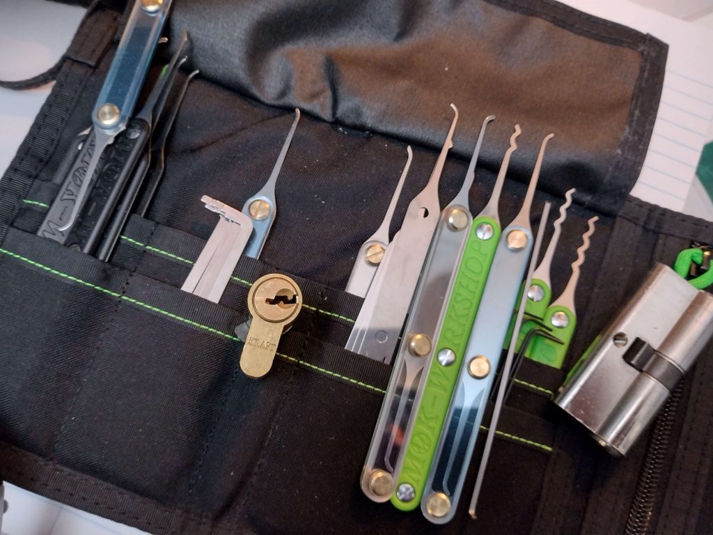

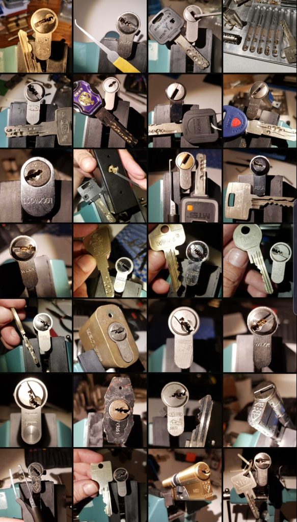

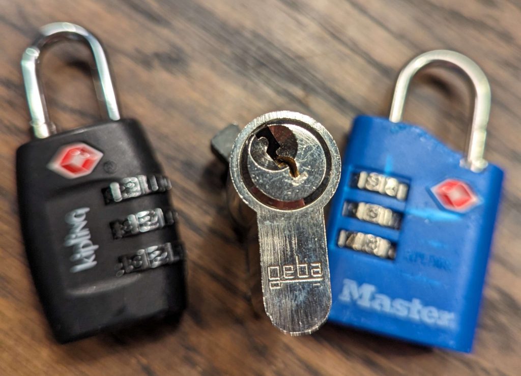

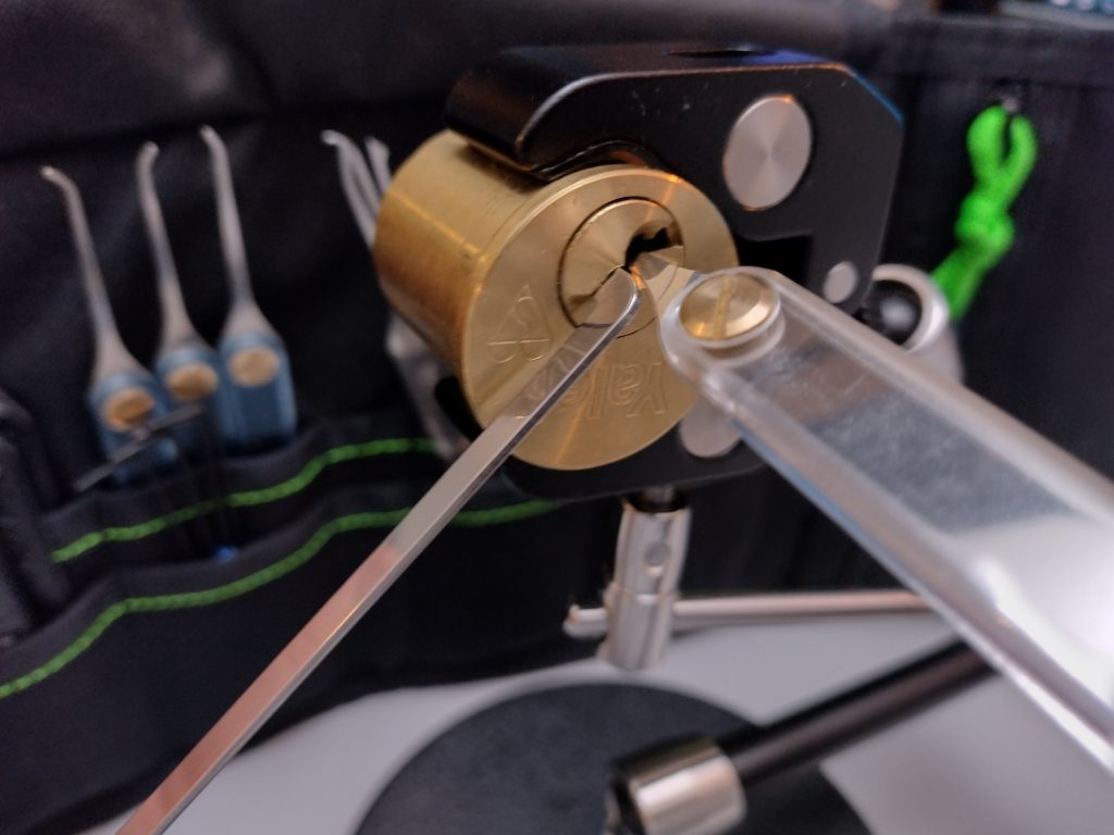

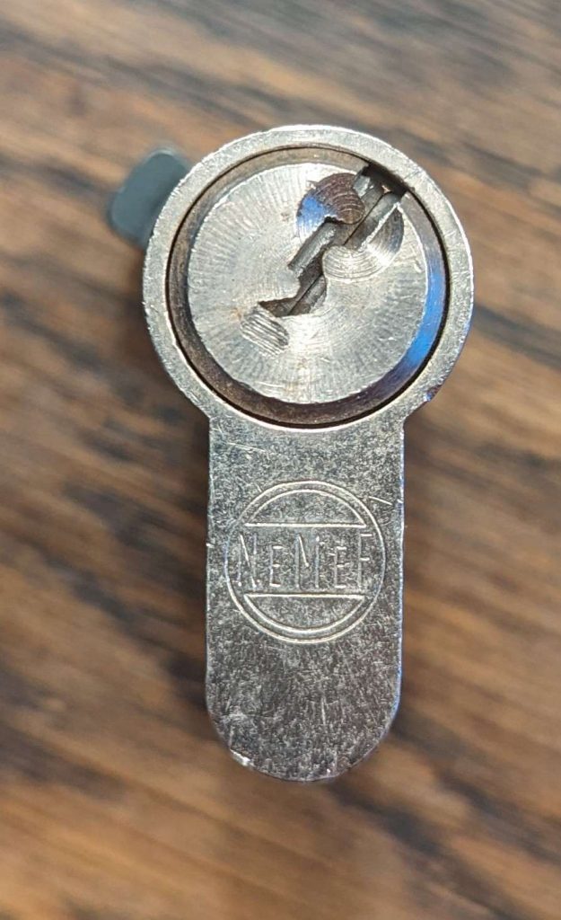

    Picking a lock a day has helped me to get use to my new thick acrylic Moki handles, and taught me a few new picking tricks. As the month progressed, I attempted quite difficult locks, of which most didn’t open, at least not right away. For example, I’ve played an hour a day with a particular BKS, which still remains shut. When a lock didn’t open after a while, I frequently tried another lock, if not to keep the streak.
    Walter picked a DOM, Pfaffenhain, Nemef, Mul-T-Lock, Wally, Anker, EVVA, ISEO, Gerda, CES, Ivana, Geba, Novoferm, Wilka, FF, Abus, Thirard, Yale, Vachette, Lips, Pratic, S2, Sobinco, Mauer, Corbin, BASI, VBH, Zeiss Ikon, Destil, Kale and an M&C.

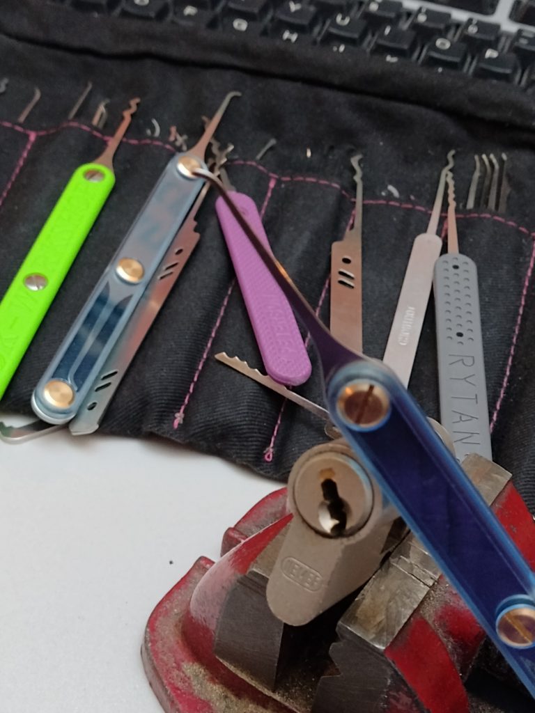

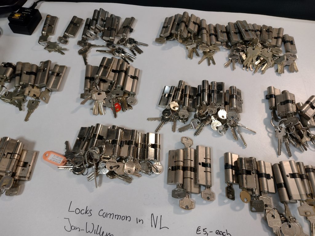

    On the other hand Jan-Willem picked the Kibb, Dom Sigma, Abus C83, MD, Anker, CAS, Gerda, Lockinox, Nemef, Pfaffenhain, Kraft, Nino, Gaba, (another) Lockinox, Bern, Yale, Axa, S, Era, UAP, Evva, M&C, F (can’t recall, federico? fred?), Iseo, Fake Assa 700, (2nd) gaba, corbin, mila, Ivana, Favour, and a SEZAM cylinder.
    By Jan-Willem. Pictures CCYBY4.0 by Walter and Jan-Willem Toool Blackbag.

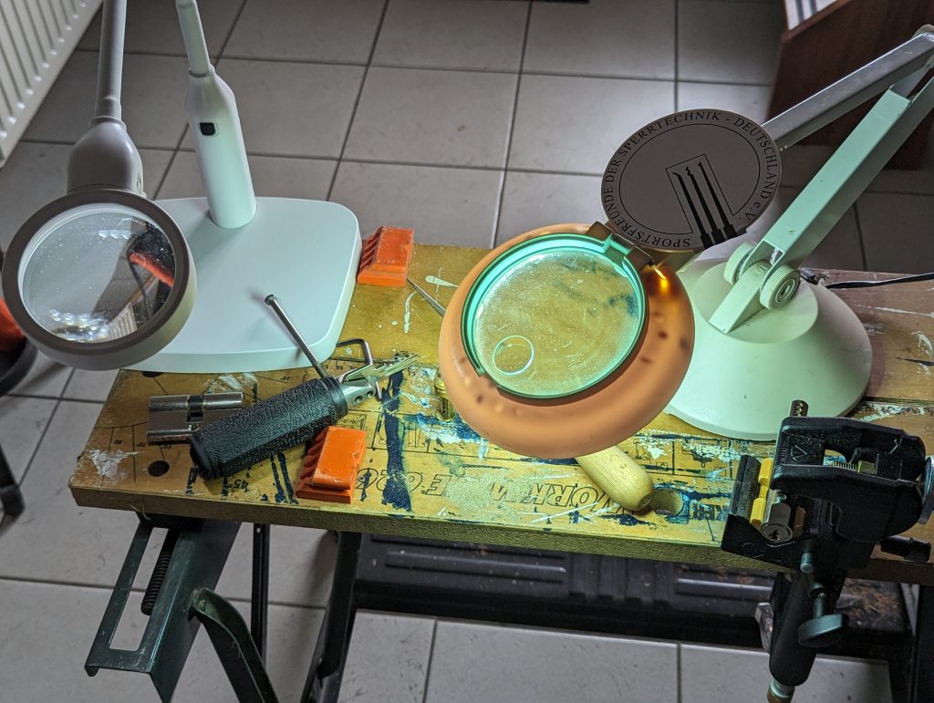

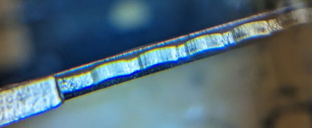

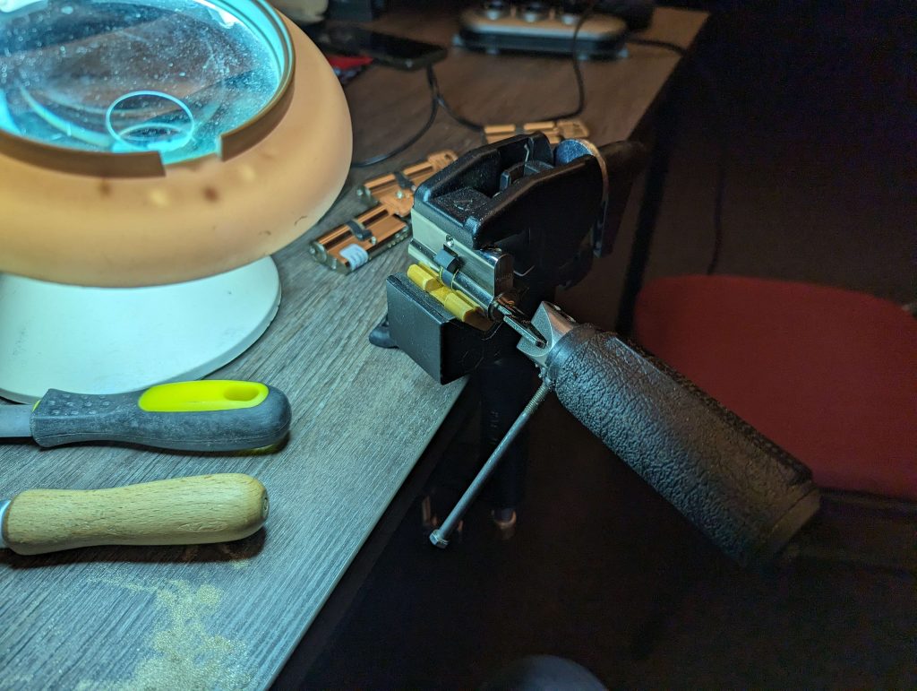

    Impressioning light
    At the impressioning championships in Germany at Wendt, organised by SSD e.V., I noticed somebody using a light I had not seen before. Since my own light/loupe is incredibly old and almost falls apart, I decided to buy one as well. It’s the “Maginon Tischlupe TL-120”. I bought one for €27.32 including shipping from Germany, […]
    At the impressioning championships in Germany at Wendt, organised by SSD e.V., I noticed somebody using a light I had not seen before. Since my own light/loupe is incredibly old and almost falls apart, I decided to buy one as well. It’s the “Maginon Tischlupe TL-120”. I bought one for €27.32 including shipping from Germany, with that price it’s worth to give it a shot.
    I set up a little working space to compare my old light, which has a TL light, and the new light, which uses LED.
    Both are flexible. The Maginon has a nice heavy base, but you can also attach it to a table clamp (included with the light). Apart from the small loupe, there is also a bigger loupe but that does not offer the same magnification. The little ‘eye’ in the old loupe has the most magnification. The LED of the Maginon is attached just below the loupe, you can see some LEDs shining through the glass in the picture above. The LEDs can be shivelled from shining horizontally to almost vertically.
    What is nice about the Maginon is that it can be battery operated (3 batteries included), or you can power it via USB-C (adapter and cable also included). The button switches between no, medium or high illumination. So I went on and filed a key, looking for marks using both loupes.
    Unfortunately, I was not able to make decent pictures on the old loupe. The above one shows a distorted key which is due to the little loupe and camera interfering. In reality, the marks were visible very well.
    Using the Maginon, what I first noticed was the fact that it does not magnify as much. I prefer my old loupe as far as magnification is concerned. I had to play a bit with the angle at which the LEDs are places. Shining horizontally doesn’t work well as it doesn’t illuminate the whole surface in a uniform way. Shining almost vertically causes a lot of areas to shimmer which also doesn’t work well. Putting the LEDs in about a 45 degree angle gave the best results.
    Interestingly, sometimes I saw a mark better on the Maginon than on my old loupe, but the reverse also happened. The marks of the pins riding over the key were certainly easier to spot with the Maginon. In the above picture, clear marks can be seen.
    The light of the Maginon, being LED, is whiter and more unnatural than the TL light of my old loupe. The key under the Maginon shows all sorts of colourful artefacts. In the end, I prefer my old loupe, mainly because of the higher magnification. The selling points of the Maginon are its price and wireless operation. The selling points of the old loupe are the maginifaction and the natural light. In the end, I filed a working key.
    I will probably take the Maginon with me to upcoming competitions, both as a backup (always make sure you have backups!) and as a device to give me a second opinion, when I doubt a mark I am seeing on the old loupe. Having a second loupe at the table could provide the mark that is needed to continue.
    CCBY4.0 Walter Belgers Toool Blackbag
