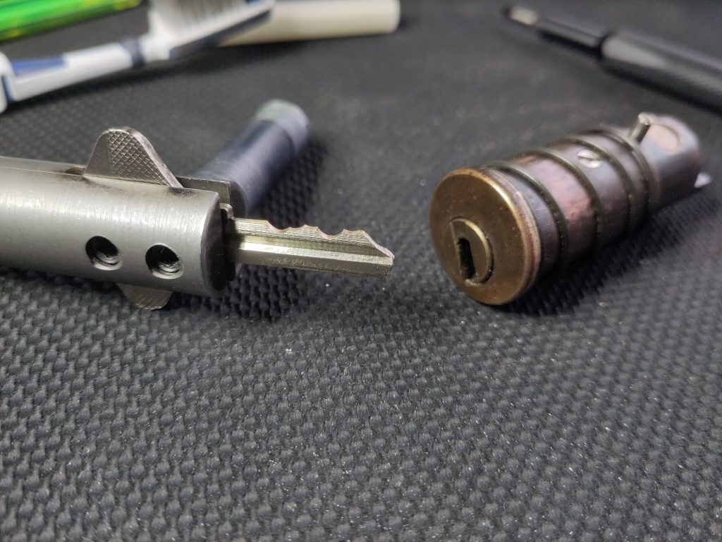

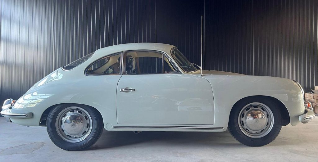

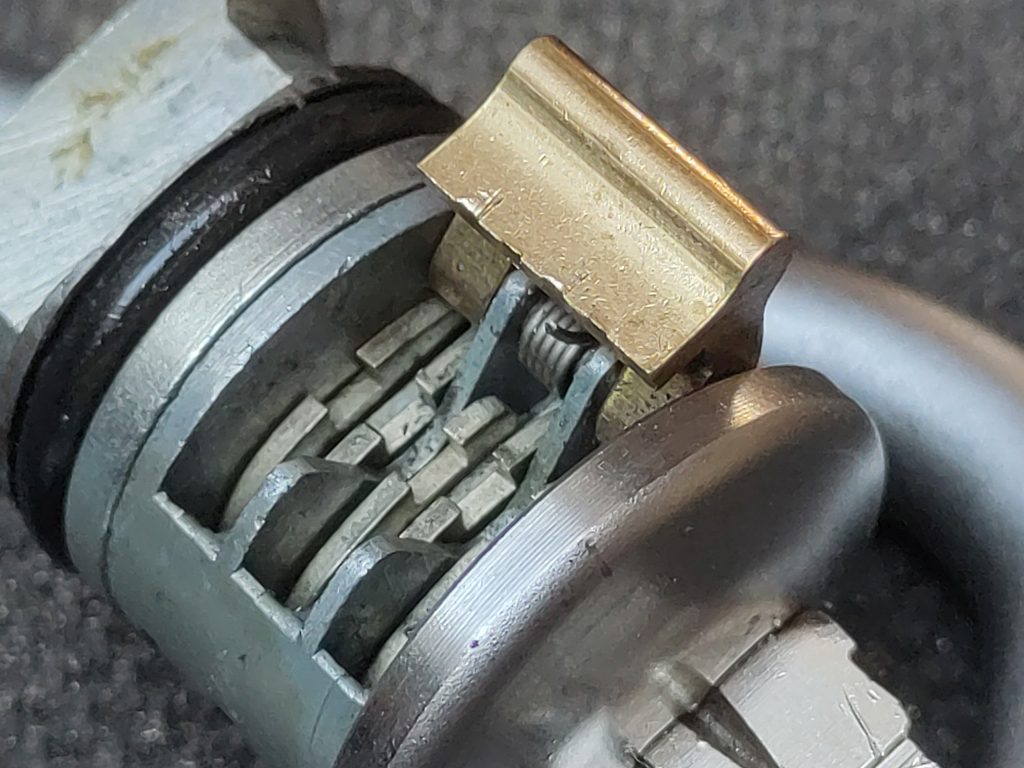

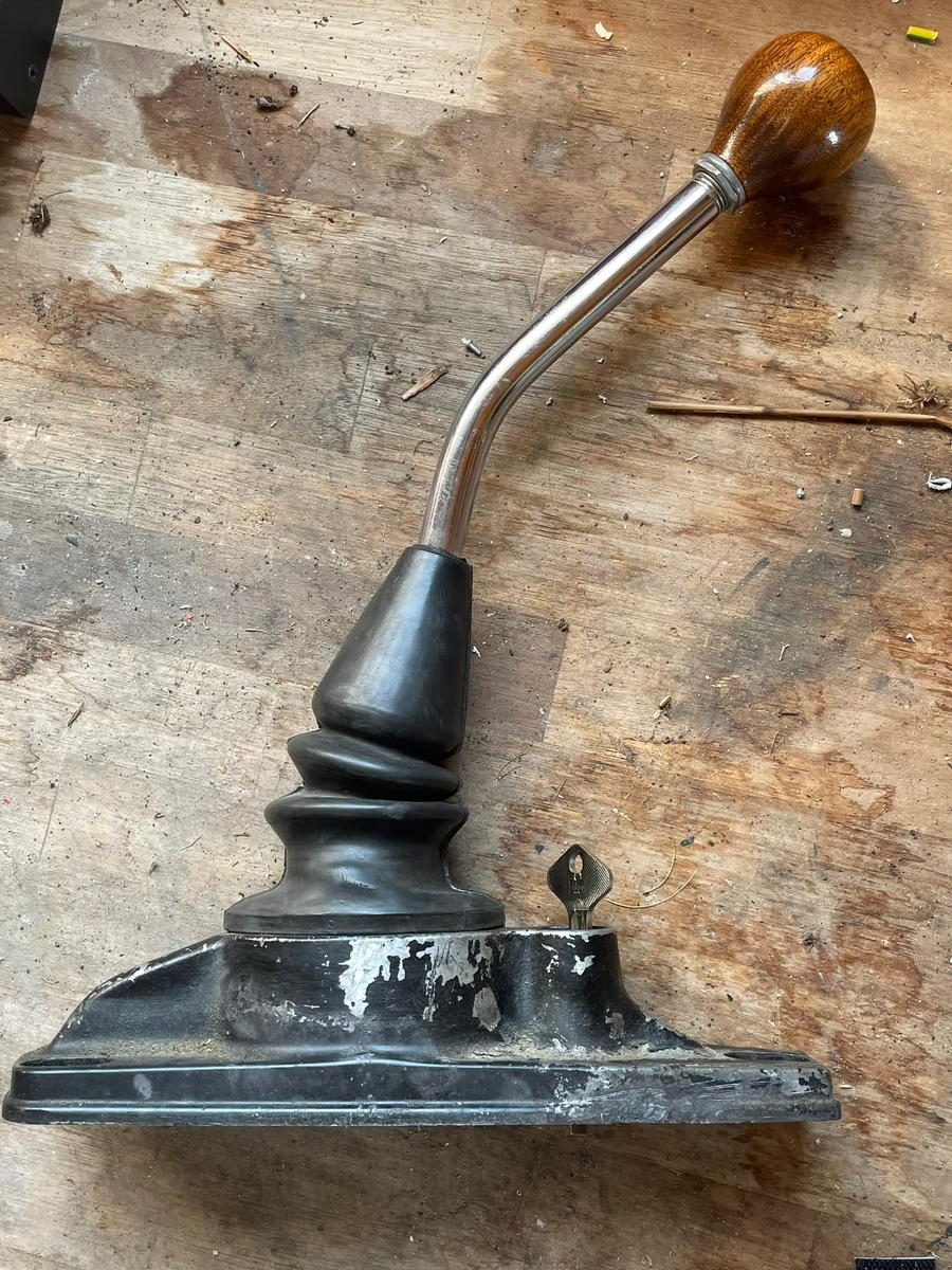

    Impressioning a Porsche 356 gear shift lock
    I don’t consider myself much of a car person, but this Porsche 356 from the 1960’s is a work of art. The owner imported it from the US, and a keyless gear shift lock was added in the sale. The current owner had almost given up the hope of finding a working key for it, […]
    I don’t consider myself much of a car person, but this Porsche 356 from the 1960’s is a work of art. The owner imported it from the US, and a keyless gear shift lock was added in the sale. The current owner had almost given up the hope of finding a working key for it, when he read about Toool in an old Quest magazine.

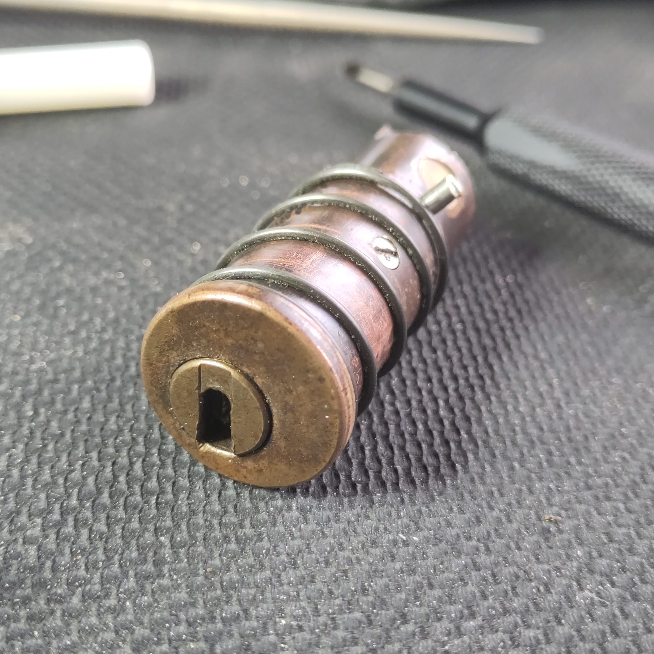

    The gear stick with the lock to the rightLearning of a community of lock enthusiasts, he contacted us hoping we might have a solution for his problem, and luckily we did. I immediately thought of impressioning a key for the lock. After emailing back and forth a bit, the owner ordered blank keys and arranged for him to visit me after they got in from the UK.
    The lock cylinder. Note two screws: one in the middle to hold the plug, and a longer one in the back used to install the cylinderA couple of weeks later, after the blanks arrived, we arranged to meet and impression some keys. This was the first time I saw the cylinder, and I was surprised to find out it was a five pin cylinder and not a wafer lock as I expected from a car lock. The blanks were from Ilco, DM2, and brass.

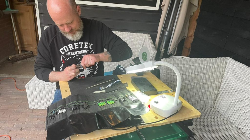

    Your’s truly at workImpressioning was pretty straightforward, but I did encounter some interesting things:
    • Impressioning a used, old lock has it’s own challenges. Wear and dirt made getting marks take a bit more time. It felt dampened and “muddy” (for lack of a better word);
    • The brass used for the blanks was very soft. I was afraid to use a lot of force, because I didn’t want to unnecessarily break the few blanks I had;
    Luckily I didn’t break any blanks. I took my time checking marks, only filed when I was certain there was a mark (as I know I should always do, but sometimes forget in the heat of the moment). Then after about half an hour the key suddenly turned. But only once, I couldn’t reopen the lock with it. Closer inspection showed two deep craters on 1 and 4. Slightly filing those down left us with a smooth working key. Beforehand I had warned the owner that the process might take a while and multiple tries, so we were both surprised and very happy with this swift success.
    The end resultI really enjoyed doing this project. Not only did I get to practice my impressioning, but we also had a nice conversation about how much fun it can be when different hobbies suddenly overlap. Lately I have realized this is one of the things that keeps me going back to the locksport community: meeting people from all walks of life and discovering there’s always something connecting us.

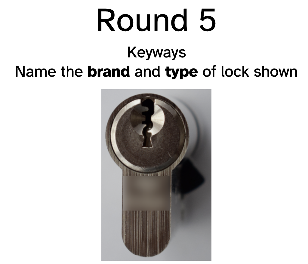

    The LockCon LockQuiz
    For this years’ LockCon, I decided to not do a lecture about a lock-related subject, but to organise a lock-themed pubquiz, the “LockQuiz”. I like the old-skool quizzen where you work together in teams and write down your answers on paper. Modern app-based quizzen have their own charm, but that was not what I was […]
    For this years’ LockCon, I decided to not do a lecture about a lock-related subject, but to organise a lock-themed pubquiz, the “LockQuiz”. I like the old-skool quizzen where you work together in teams and write down your answers on paper. Modern app-based quizzen have their own charm, but that was not what I was going for. When I play a quiz, I like questions where teamwork leads to the correct answer.
    So I went about to see if I could come up with enough locksport-related questions and categories. I ended up with 68 questions in 6 rounds. In round 1, I showed lock cylinders and padlocks, with the brand name removed and the teams had to tell the brand. In round 2, lock-related books were shown, with one word (partially) blurred, the question was what the word was. Round 3 was another picture round with pictures of tools, where the question was which toolmaker the tool was from. After a small break, we continued with round 4, in which I asked for names of movies in which something lock(picking) related was shown. Round 5 showed keyways, asking for the brand and model, and round 6 was a music round, showing clips that had something to do with locks as well. Requested was the name of the artist.
    I got very good feedback and everybody seemed to really enjoy the quiz. I have made generic pubquizzes before and know that the biggest pitfall is to make them too hard, which is no fun for the people doing the quiz. That is why I included answer sheets for the (rather difficult) movie and music rounds, that showed the number of letters in the answer and also had some letters filled out in advance.
    The quiz had a clear winner, which was good, as I had not thought of a tie-breaker question. In the end, 77% of the questions were answered correctly, which is wonderful, as that was what I sort of aimed for, but it was hard for me to know how difficult it would be in advance. The lock brands round turned out to be the easiest, the music round the hardest, but even that round had 74% correct answers, thanks to the answer sheets.
    If anybody wants me to do the quiz elsewhere, contact me. Obviously, the people at LockCon already know the answers. Or, if you have suggestions for other topics for rounds, or questions, I’d be interested in those as well. And finally, if you’ve made pictures of me presenting, I’d love to have a copy as well.
    And again, congratulations to Team Baguette, who won!

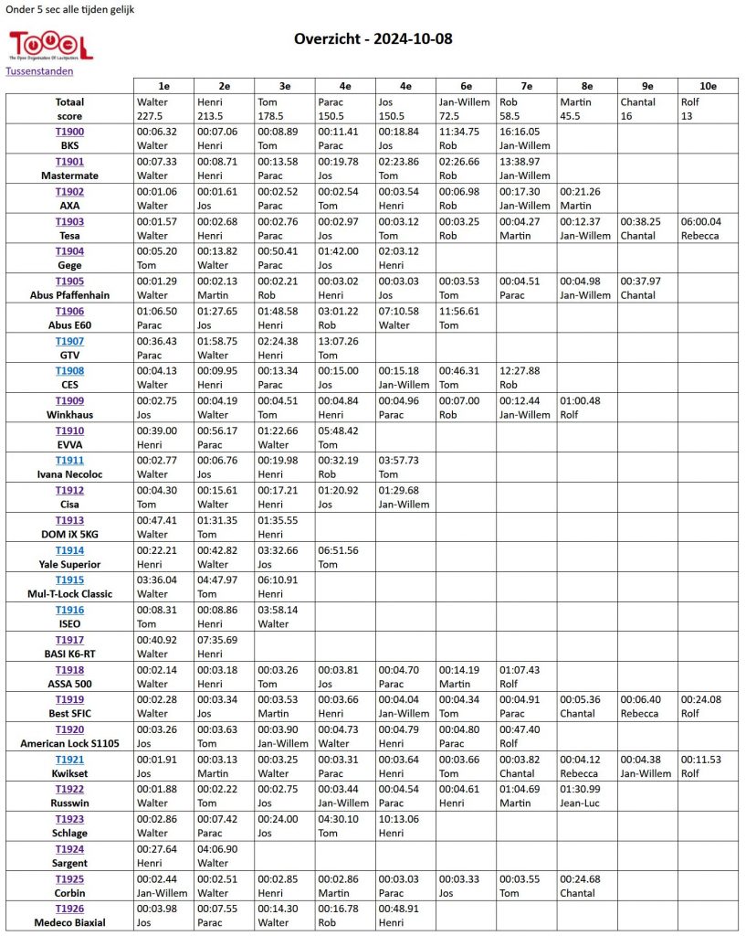

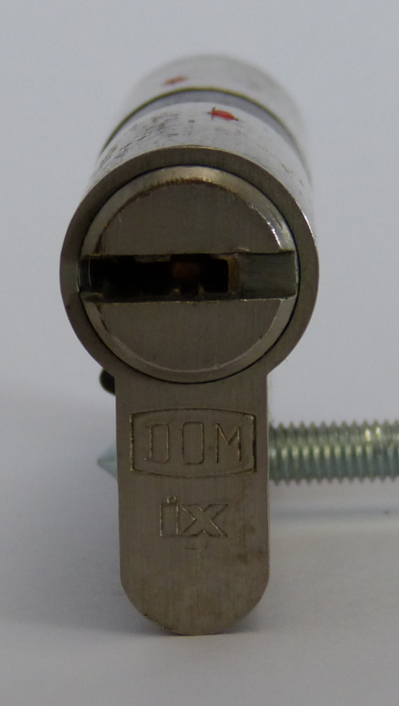

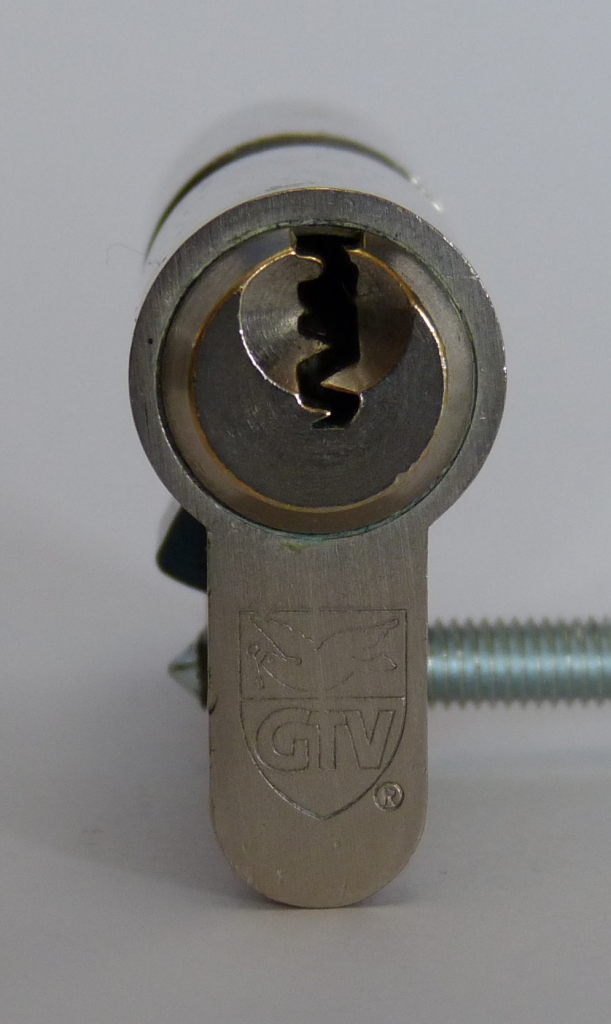

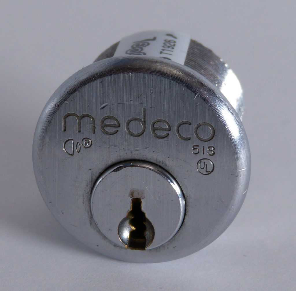

    Toool NL competition 2024 – analysis
    The 19th Toool NL competition is concluded (https://toool.nl/competitie/). The Toool members worked on lockpicking a set of 27 locks over a period of one year, and registered the quickest opening times. The full competition details can be found on https://toool.nl/competitie2024/. Before we started picking, Walter asked the Toool members to make a guess on the […]
    Before we started picking, Walter asked the Toool members to make a guess on the best opening times for each lock. With this data he expected to see which locks are perceived to be difficult, but were not, or vice versa. Four lockpickers made their guess, and we analyzed the data.
    Please note, the final opening times are heavily skewed in favor of short opening times, as the locks are picked several times at the Toool meetups and only the lowest time counts. A lock may be opened in 15 minutes during the first attempt, but during several meetups the final opening time can be reduced to five seconds. Many of the locks in the competitions are perfectly suitable locks, and us opening a similar lock in five seconds, shouldn’t be the reason to replace yours.
    We found this data isn’t easy to visualize in a single graph, as each lock is unique. We chose to break down the analysis results and report on the five most underestimated locks and the five most overestimated locks.
    CylinderBrandFastestLockpicker 1Lockpicker 2Lockpicker 3Lockpicker 4T1906Abus E6066.5074.00630.005.0020.00T1907GTV36.435.00940.0030.0015.00T1910EVVA39.00420.00304.0060.0015.00T1915Mul-T-Lock Classic216.04360.00312.00120.0045.00T1924Sargent27.64150.00925.005.005.00Underestimated locks from the Toool NL competition 2024
    CylinderBrandFastestLockpicker 1Lockpicker 2Lockpicker 3Lockpicker 4T1913DOM iX 5KG47.41240.00985.00120.00200.00T1916ISEO8.31180.00781.0060.0025.00T1918ASSA 5005.00120.00610.00180.0045.00T1919Best SFIC5.00240.00558.00180.0020.00T1926Medeco Biaxial5.00132.00121.00600.00180.00Overestimated locks from the Toool NL competition 2024It is quite interesting that only a few locks were underestimated, while most locks were overestimated. Several of the underestimated locks have a tight keyway, but this in itself is not a guarantee for the lock to be difficult. For example, it’s common for the old Evva to be full of standard pins. The biggest surprice is the Sargent lock, which is much better quality than they are usually given credit for.
    On the overestimated side, we have locks which are usually quite secure. The Medeco has good tolerances, and the SFIC rely heavily on their double shearline for security. While the Assa 500 and DOM IX are well-made locks from Europe. However, with the right tools and techniques, they just opened without too much difficulty. (The Medeco was raked several times.)
    This analysis and report may not have solved the mystery of why some locks are easy, and other locks are difficult, but it was interesting to analyze these nonetheless. We will not take guesses for the 20th Toool competition, but do take a look. https://toool.nl/competitie2025/ We chose to save all the keys of this new competition, which enables us to see if the bitting is what makes the difference after the competition concludes.

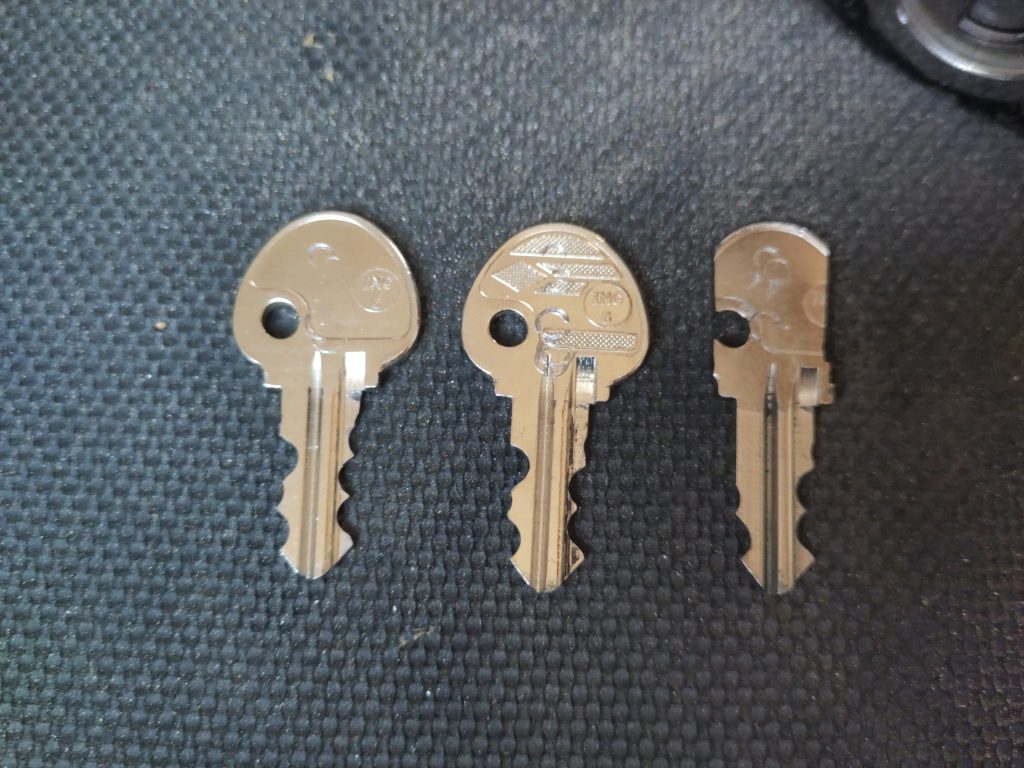

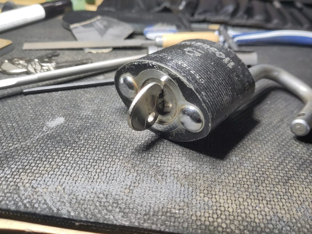

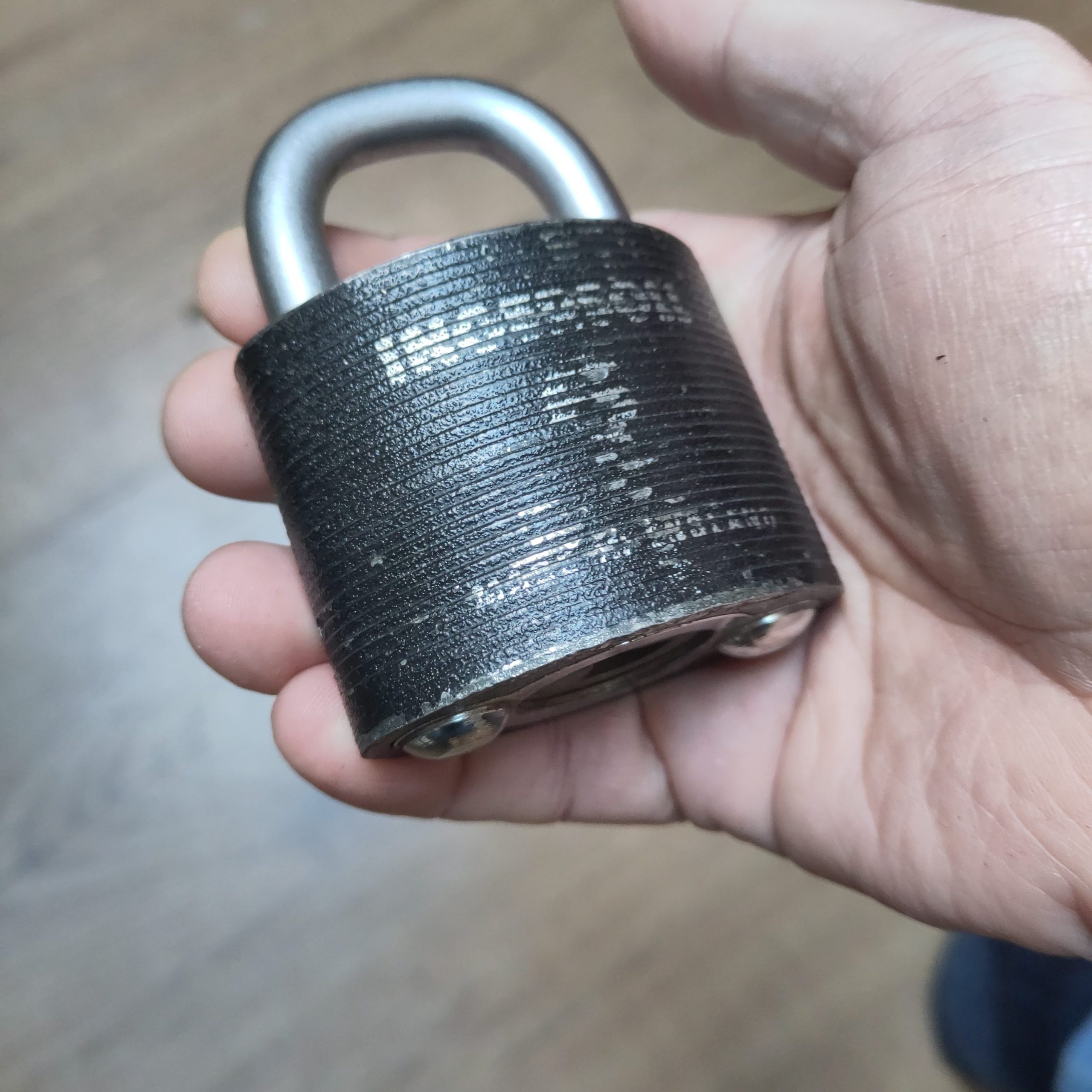

    Impressioning a key for an Ingersoll 6 padlock
    This keyless padlock was sent to me by a friend as an impressioning challenge a while ago. At LockCon 2024 I was able to get some fitting blanks from a friend, so I could finally get to work. Below you can read about my experience with impressioning a key for this lock. First two attempts […]
    First two attempts
    Starting out I approached the impressioning like I would with a pin tumbler cylinder, by preparing the blank. Since the blanks were steel, I didn’t need to remove any plating, but the surface was very rough so I made it smooth (a mistake, but more about that later).
    Tried to figure out the spacing, but it was difficult to see so I tried to get some marks. The first mark was not difficult to find, because the levers bite in the edge of the blank. Marks stayed on the edge, but switched sides from time to time. As cuts got deeper, marks started to get wider and cover more of the surface of the edge.
    From time to time marks reappeared on levers I worked on earlier, I think this might be caused by the shape of the levers. I remember from picking other locks with a similar mechanism (Miwa U9, Google Page Ranking) that before getting them open I spent some time tapping multiple levers to set them again. So I took the reappearing marks as a clue that I was getting closer to opening.
    I decided to stop my first attempt after working on several levers like this for quite some time without feeling I was getting closer to opening the lock, so I decided I must have filed too deep somewhere earlier. When I tried to figure out the spacing earlier, I removed some material on the first cut on the left and I suspected that might have been too much.
    I started the second attempt by preparing the blank again, but didn’t try to find the spacing. Instead I use the key from my first attempt as a reference to make some guiding marks on the side with a marker. Most of that second attempt went like the first, and when I decided to take a break I was looking at two near identical attempts.
    Time to think
    With only one blank left I decided to take some time to work on other projects and think about possible mistakes I had made in the first two tries.
    A conversation with someone about the blanks used in the SSdeV impressioning competition at the Wendt Hausmesse earlier this year finally put me in the right direction. During that competition, in the final round we had to try to make keys for several different cylinder models. Obtaining blanks for some of those had turned to be difficult so on those we had to use universal blanks. One of the downsides we encountered was that sometimes preparing the blank like we were used to, left us with a blank already below the zero cut height. Since I already suspected there could be zero cuts on Ingersoll keys, could it be that I had been setting myself up for failure by preparing the blanks?
    Third attempt

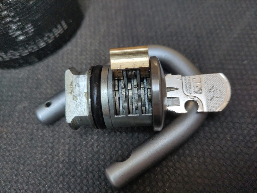

    Feeling motivated again, I decided to clamp up that final blank. Not having prepared the blank, I took my time finding the first mark. It was a pretty clear “bite”, but before I started filing I wanted to make sure I didn’t miss any other obvious marks. After this the impressioning was very similar to the previous two attempts. I just had to remind myself to check if new levers started to make marks from time to time. And of course the biggest difference was the key finally turning. I did encounter an unexpected surprise though: the key turned freely but I was unable to remove it.
    Open! But the key is stuck…Troubleshooting
    After some online research and asking around, I managed to remove the shackle from the padlock, so I was able to remove the core and find out what prevented the key from being removed. My initial thought was canyoning, even though I kept an eye out for that during the impressioning. The real cause was totally different, and not really something I could have prevented. The key wasn’t perfect, but had allowed the gates to align just enough for the sidebar to drop in under tension. After that though, It was stuck so tight that the sidebar springs were too weak to lift the sidebar out again.
    Obvious damage to the sidebar where it was forced in a gate. Also note the shallower traces caused by pushing the bar against the levers during the impressioning processConclusion
    I think the only thing that might have prevented this from happening is having a list of all possible cut depths and making sure to file exactly to those depths on the exact right location of the blank. Should I ever try this again, obtaining a list of the cut depths and making some sort of jig or guide to help with the spacing would help out a lot.
    Henri/Greenish
    Gates where aligned just enough for the sidebar to drop inFrom left to right: first attempt, second attempt, final working key

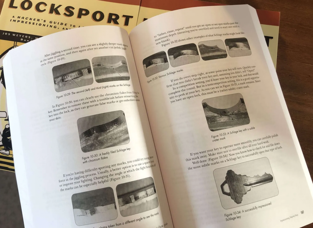

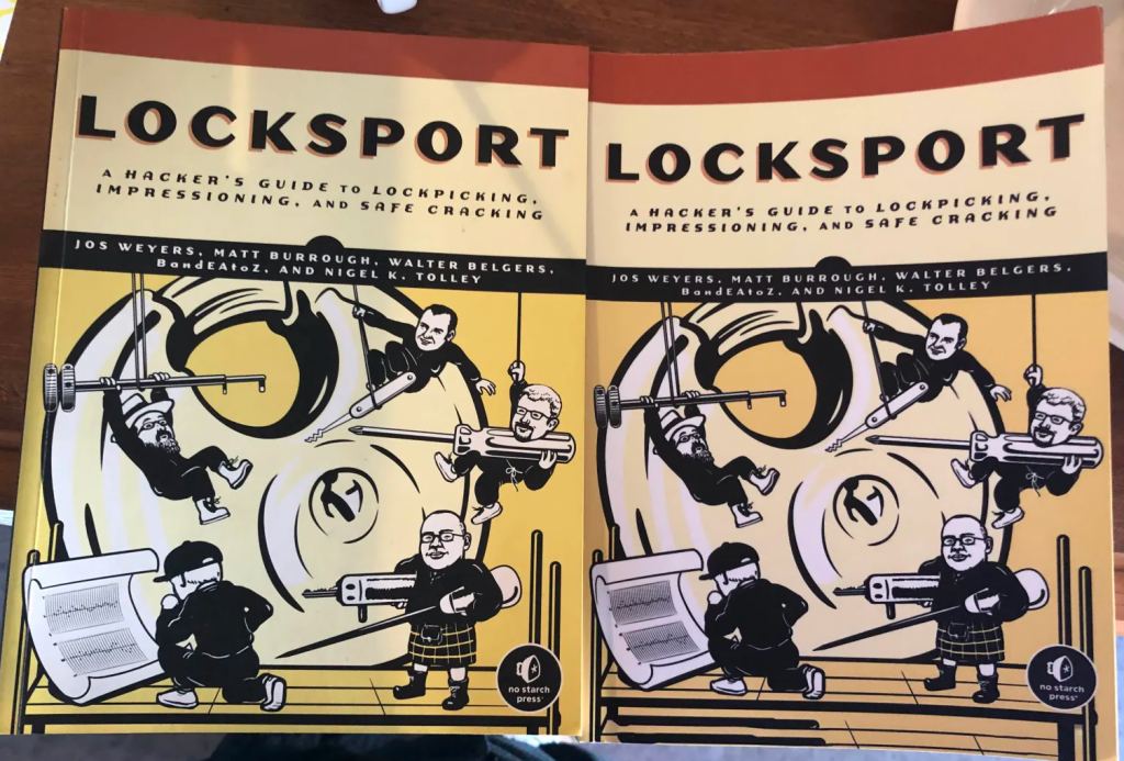

    Bookleg: Locksport

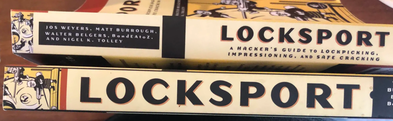

    Dear hacker friends, it has been brought to our attention that physical bootleg copies of Locksport are in circulation. While imitation is the sincerest form of flattery, bootleg copies are a near 1:1 copy without any additions or changes. This is uninspiring freeloading. At the moment of writing, two official versions of Locksport by No […]
    At the moment of writing, two official versions of Locksport by No Starch Press are in circulation, the Defcon version which doubles as the uncorrected proof with 367 pages, and the release version with 383 pages. Several pre-print versions of selected chapters were shared as PDF for preordered books directly from No Starch Press. Similarly, a DRM-free copy is included with the purchase of physical copies.
    After thorough investigation — by placing the copies next to the original work and comparing the differences — we have determined several key differences. Please take your copy from the shelf and compare it to the pictures below.
    The book on the left of the image is the version released by No Starch Press. This book measures 177 mm in width and 235 mm in height. 7″ by 9.25″. The bootleg copy measures a centimeter (50/127″) smaller in the width. This resulted in the image depicting the authors with their favorite tools seemingly squished, and two more black lines on the bottom are added, The No Starch Press logo is slightly more oval as well. You may also note the slightly more orange tint of yellow used in the bootleg copy.
    The book on the bottom of the image is the version released by No Starch Press. The differences are quite clear, where the original has the full name written out, the bootleg has the title and subtitle on the edge. The names on the No Starch Press version are the last names of the authors, and the bootleg version has the full names as shown on the cover.
    The last difference we want to share is the glaring lack of color in the pages of the bootleg copy. The authors of Locksport and No Starch Press take pride in the full color images in the original book. This makes this book a bit more expensive, but the results are totally worth it.
    Thanks, Jos, for lending me the bootleg copy of the book and the pictures for this blog. I’m glad you can laugh about it.
    All No Starch Press copies have several key indicators to make counterfeit books practically impossible. Before accepting a Locksport book, please check if the book is legitimate. Furthermore, if you ask the authors to sign your counterfeit book, it’ll be ceremoniously thrown through the room, and you are expected to be uninvited to all Locksport authors birthday parties.
    We will keep monitoring the situation and keep the hacker community up to date when new discoveries are made. Thanks for your continued support!

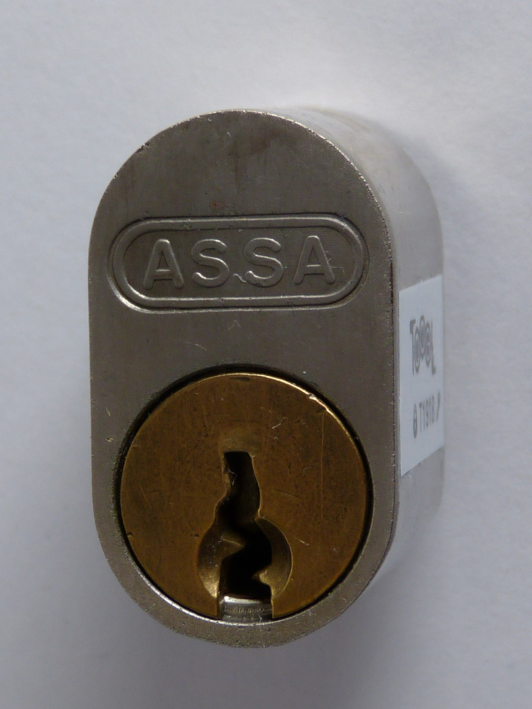

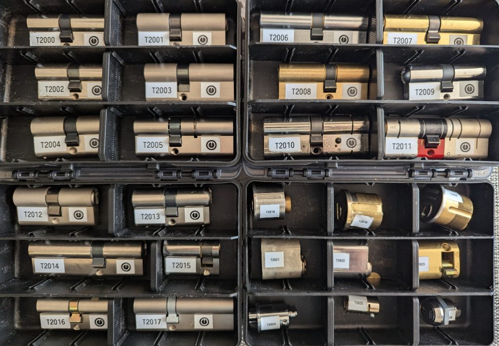

    Toool competition – we have a winner!

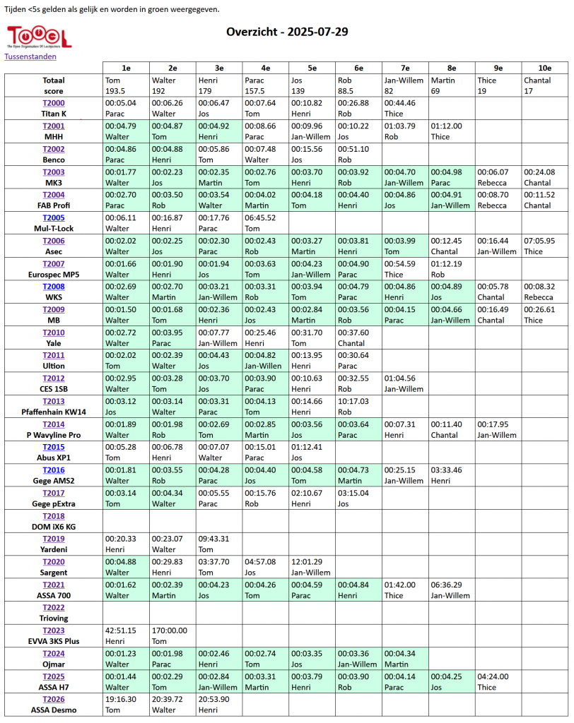

    The Toool lockpicking competition is held yearly from 2004 onwards. About 25 locks are selected and it is up to the Toool members to try and pick them at Toool gatherings. They can spend as much time as they like, and can retry to open a lock as often as they like. Scores are given […]
    The Toool lockpicking competition is held yearly from 2004 onwards. About 25 locks are selected and it is up to the Toool members to try and pick them at Toool gatherings. They can spend as much time as they like, and can retry to open a lock as often as they like. Scores are given out depending on opening speed, 10 points for the fastest person up to 1 point for the 10th time on the lock. Since some locks can be opened with just a single rake, times under 5 seconds all count as the same time.
    Every year, locks are selected on what we think are good locks, meaning: they cannot be opened in a single rake, but can be opened within the year. This year, there were 26 locks and the mix looked like this:

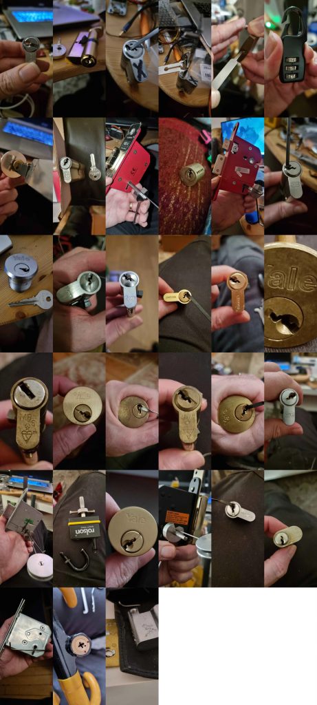

    The locks from the 20th Toool NL competition. More details and pictures are found on: https://toool.nl/competitie2025/Having won 18 of the 20 competitions so far, I was keen to win again, but everybody is getting better! I am a very fast picker, but it is not just speed, it is also making sure you open all the locks. In the end, there were a few locks that were only opened by 5 or less people.

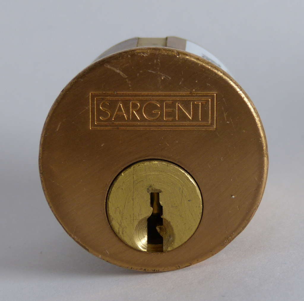

    The Yardeni and Sargent looked simple, but turned out to be hard. The Abus XP1 was left unpicked for a long time, mainly because it has a reputation of being very hard to pick. When it turned out to be (quickly!) pickable, it got 5 openings.

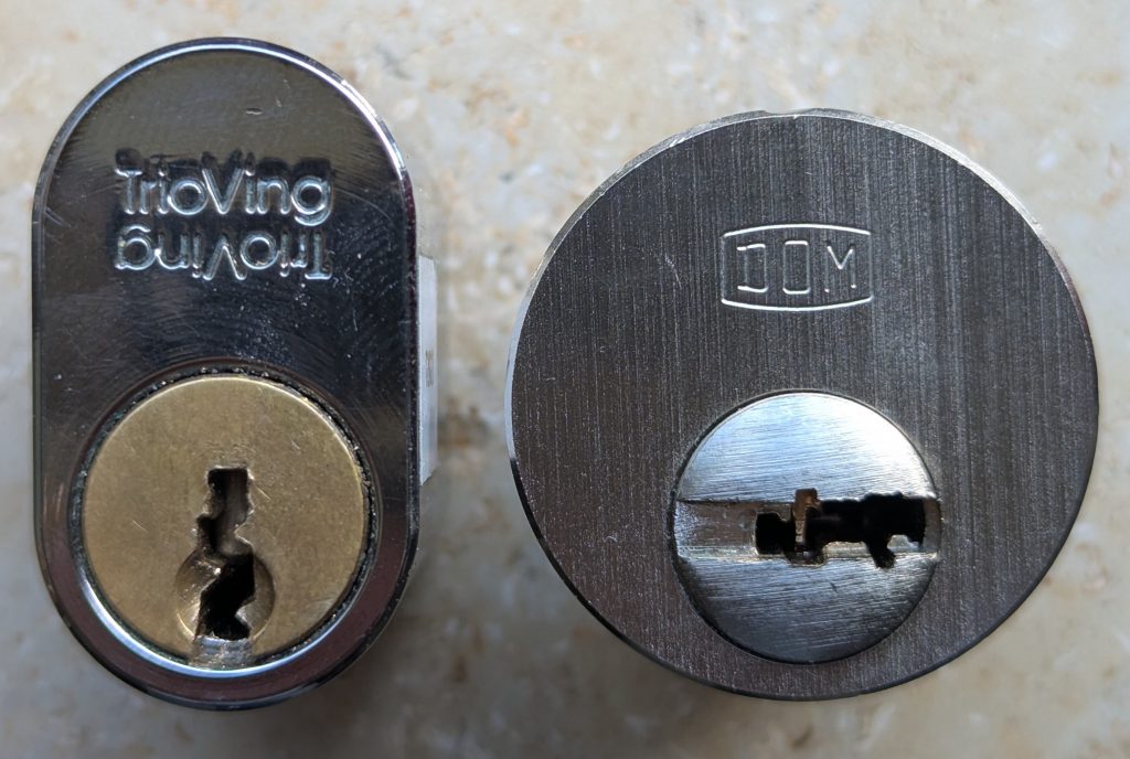

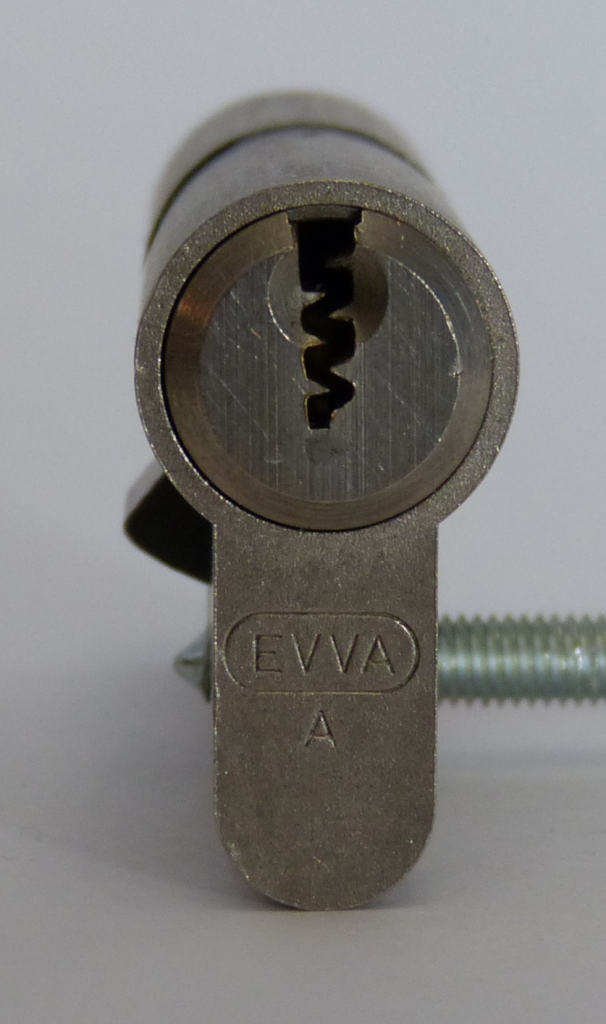

    Then to the hardest locks. The EVVA 3KS was my personal nemesis. There is only so much time you can practice on these locks (only during gatherings). For the first time, I resorted to practicing at home. I took an EVVA 3KS I had in my collection, created specialised picking tools and practiced until I could open it. However, the 3KS in the competition would not budge. The main problem being that, when moving some sliders, the lock would reset (which my own 3KS would not do). I’ve spent quite a few hours on this 3KS to no avail. It was opened by Henri who became third, and by Tom who won this year’s competition by 1.5 point. Congratulations Tom! The three of us opened the same locks (except the 3KS for me) but I scored higher than Henri because of my fast openings on the locks I did open.
    Since a 3KS is easy to disassemble without having the key, I took a look at the insides, to see if there was anything that can explain the resetting of the lock, but everything in there seemed very normal.
    These are the two locks that no-one opened. The TrioVing does give feedback while picking, but nobody succeeded in opening it. The DOM was picked into a false set but also never opened. The pins have a shape that makes picking quite hard.
    I am looking forward to the next competition. This one was exciting right until the end. The last gathering I decided to not work on the 3KS but try and gather a few points by improving times on simpler locks. At the start of the gathering, I was only half a point in the lead, and was able to gain another point by improving my time on the Benco lock. The Benco I don’t like, as I don’t really get a good feel of how to pick it. Tom was trying to open a new lock (such as the DOM above) for maximum points, but then changed strategies and improved his time on the Desmo, giving him a 1.5 point lead. I only realise now, writing this, that improving my time on the Benco with another 2 seconds would again have been enough for the win. That is how close this years’ competition was!
